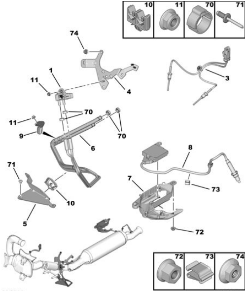

Ok, so that part number (8) on the diagram below was the original number and has now been been superseded by: 9821120980. The modified part costs £324.36 inc. VAT from Citroen as of today. The older sensor was priced at £262.48.
Item (3) is the exhaust gas temperature sensor.
Item (6) is your Particle Filter Pressure Pipe.

Marc, thanks for the information. The diagram explains why I could not find the control box for what was thought to be a NOx sensor in the cat, they are double exhaust gas temperature sensors, the only NOx sensor is at the rear of the particulate filter which is a lot easier to get at.
The continental 9678570780 / 5wk96746a which is at the moment fitted, is there any gain by fitting the 9821120980 and will this require a software update or just learned via Lexia. One thing that was noticed on the NOx sensor was the silicone sleeve which covers the top of the probe and wires had been pulled off the probe so wide open to the elements.
