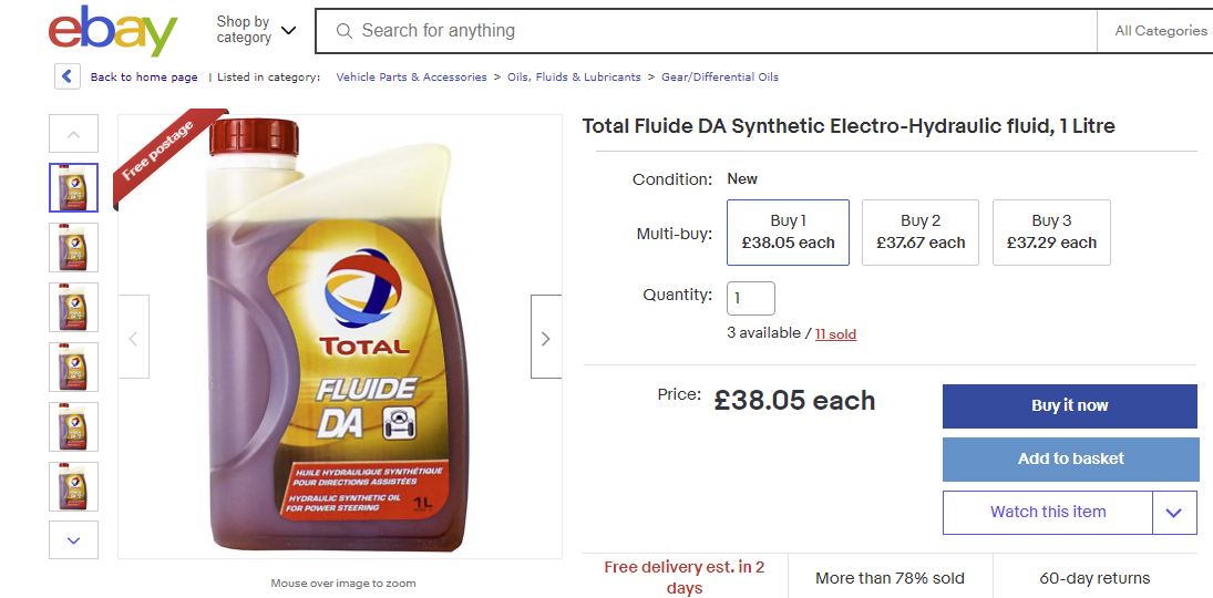

I thought I'd go down the middle, seeing as this one is £38.05 a litre....
https://www.ebay.co.uk/itm/164002242646

Christ that's liquid gold surely? How much does the whole suspension system hold?GiveMeABreak wrote: 10 Feb 2021, 14:13 I thought I'd go down the middle, seeing as this one is £38.05 a litre....
