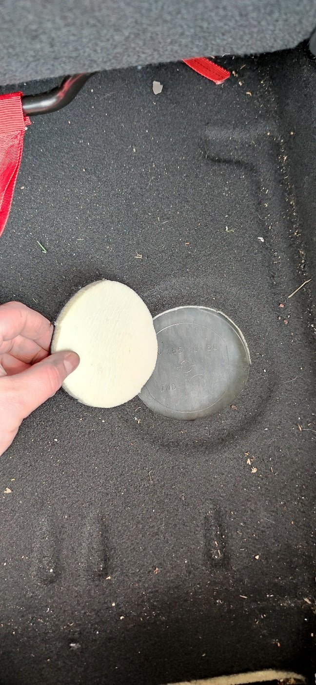

I have removed the under tray but I cannot find the additive tank. All I can see is the fuel tank. I have checked the other access points in the boot and one is covered with a plastic cover and the other is just hollow. Should the tank be visible just in front of the rear drivers wheel?

What you've found under the rear seat is the access point for the tank sender unit (for the fuel gauge). This is combined with a low pressure fuel pump on some vehicles. Underneath the car that looks very much like the Adblue container that we have on our 308. If it's not the fuel tank that is!
It does depend on the car but I think you'll find the Eolys container behind a flap on one of the rear wheel arches. Like I said, it does vary so someone who really knows will tell you for sure.

Hmm, that's interesting. That drawing looks very similar to the second photo. You can see the little recess for the hoses to clip into on both. With that in mind surely the additive tank should be visible right at the front of the same photo?
BTW, it's the fuel tank not the Adblue tank
