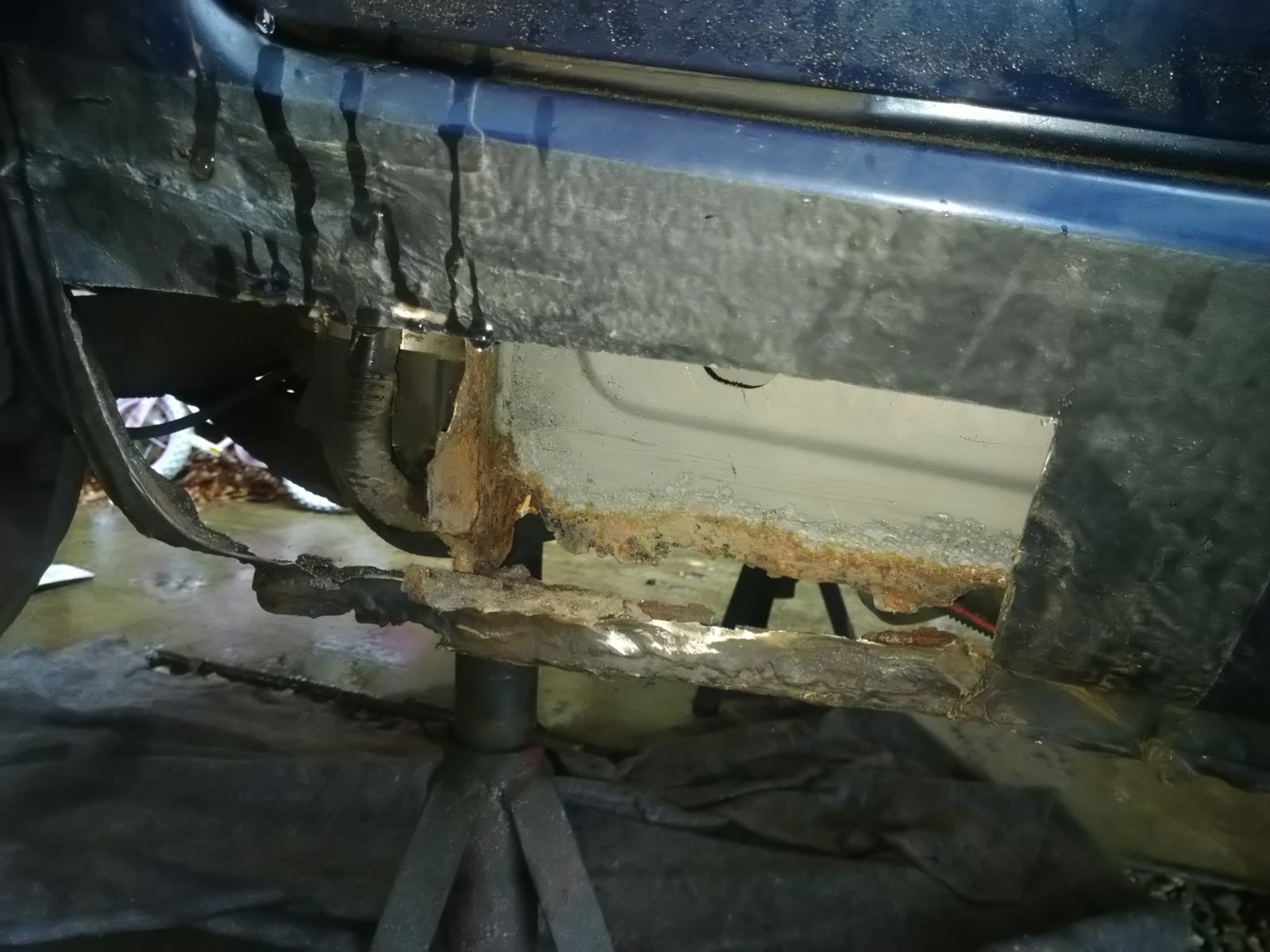

Bought a 1999 xantia at the end of November, have rebuilt the rear inner and outer sills. Now moving onto the front end, removed the front bumber to get a better look at things. Can anyone knowledgeable on the xantia answer a few questions..

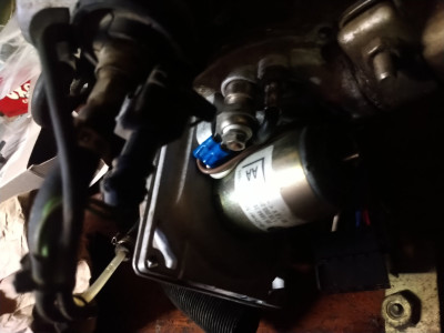

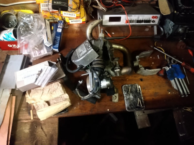

so while waiting for my parts to turn up, removed the eberspatcher heater to test the glow plug as this is the usual fault with them.. I could not find the heater on my Delphi diagnostics which is odd as you can usually check the faults out. the glow plug was dead so added that to my shopping list..
today my parts turned up, new engine mounts x2 so pressed the old out, new in and fitted the one that fits to the body.. fitted my new auto and manual tensioner, aux belt. fitted new glow plug into the heater so can fit that back into the car next, then I can try to see if I can find it on my diagnostics again, if not, not sure what way to reset the codes, if anyone has any ideas that would be a help..

Iv had them on other diesel cars, makes so much difference. I popped it back in this afternoon and it struck straight into life and tried to start a couple of times, but gave up in the end. I will give it another few goes to see if it is trying to bleed its self and if no go have another look at it... Got the engine back running again now all the mounts back on. Building it back up, but seem to have lost a grommet from the washer bottle fill pipe so stopped at putting the bumper back on, the front end is all future proofed now, with all new bolts where needed so can be removed easily...
