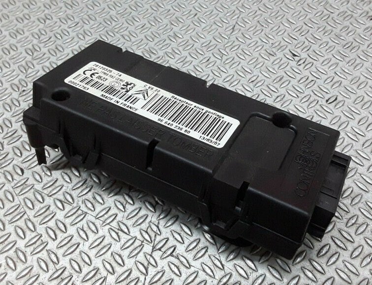

In our 2008 Citroen C4 grand Picasso, we keep we keep getting a message at about 2 - 5 km that the tire pressures have stopped being monitored. This may happen several times over a long trip. I figured that the TPMS was getting hot and failing. So I went online and got a replacement item 9664023680. I got no help from the seller as to where I should be able to find the unit to replace it. I'm hoping that some of you experienced people can stop me pulling the car into little pieces just trying to fine this monitor part to replace. Best wishes to all on the form Peter

I would strongly suggest you stop replacing parts until you know the cause.
The TPMS does not overheat.
If you have changed the wheels around or replaced the wheels from another vehicle then this is more likely to be the cause! Either that or the batteries in one or more of the sensors in the valves is at end of life. About 10 years is about the life of a sensor - but you really need to have it diagnosed to find out why. Diagbox diagnostics will be able to tell you the issue and probably which wheels are the issues.
What you have in the picture is the ECU and this is 99% unlikely to be your issue. If you replace this then the whole system will not work as the tyre sensors will need to be paired to the new ECU and that won't work if the fault is with one or more of the sensors.
Start with the simplest first, get it diagnosed with Diagbox and then that will point you to the problem if you have not recently changed wheels around.

Re: where to find TPMS CPU monitor C4 Picasso 2007-8
The car won't be able to tell you the issue - and won't recommend replacing a sensor - it cannot do that. It will telly you which tyre is underinflated / punctured or not being monitored though. The issue will be the reason why it isn't though. For a car getting on 13+ years it will have have done pretty well on the batteries in the existing sensors, so may well be that the battery is failing and the others may also start to fail if they are the originals too.
Be aware that aftermarket code readers often cannot read the manufacturer - specific fault codes on many ECUs, so be aware of that. If you do manage tyo get the codes, pop them, up here with your VIN and I should be able to tell you what it's not happy about.
I don't think you can replace the batteries in these - they are sealed units. When you replace them you will obviously need to have any new units programmed, and also paired. You will need a suitable diagnostic tool and an exciter tool to do this. Experience also shows that after programming has been completed, you can rarely pair just one of these. Usually the complete set of TPMS sensors need pairing (not coded) again. The main dealer couldn't get mine to behave after 3 visits when he tried to just pair the one problematic sensor - he realised he had to do all 4 and that resolved the issue.
