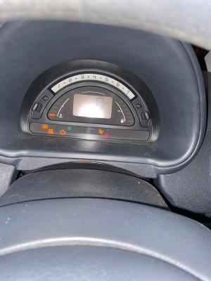

I need help with my car, the problem is
The rev, speedo and fuel gauge are not working
On top of that there are dash lights permanently on the dash such as handbrake light, airbag, engine light etc
The car starts as usual. I have disconnected the battery with no success.

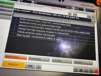

The RAC came out and scanned it and it shows
- multifunctional screen control unit, communication faulty
- Dashboard control unit, communication faulty
- Absence of communication between BSI and the ECUs of comfort VAN
Also the last owner changed the radio to aftermarket stereo so I don’t know if that caused the issues. I only had the car for 3 days.

Your C2 runs 2 types of networks. CAN (controller area network) and VAN (vehicle area network). CAN is by BOSCH and is popular in nowadays but VAN was a proprietary network architecture used by PSA.
Later C2's (post 2005) used all CAN networks.
There is only one CAN BUS in your car but multiple VAN BUSes! I can not remember if the dash is on the 'comfort' VAN or not. The radio definitely is, so the scanner is saying the BSI (the 'brains' of the car) cant talk to things that should be on the comfort VAN (like the radio).
Well we know why...the radio it's looking for is not there.
A lot of modern radios have a CAN BUS interface to make them better integrate into modern cars and "talk" to other ECU's. BUT VAN BUS and CAN BUS are not compatible. IF the radio has been connected to the VAN BUS on purpose or by accident...that could possibly stuff up things on the VAN network!
I would assume your car is a 'simple' model (no disrespect). That is; no climate control, no alarm, no reversing sensors ETC? As you haven't mentioned if they work or not. They are also on the VAN network.
I would recommend; closing all the doors and windows (DON'T LOCK THE CAR), prop the bonnet up, flip the rear window wiper arm out (off the glass). Wait 60 seconds, disconnect the battery. Remove the radio, close all the doors. Reconnect the battery, wait 60 seconds, flip the wiper back. Get in the car, turn the ignition to on and check your dash.
