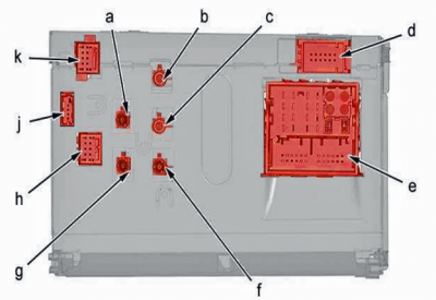

Are you aware that most NG4 systems also came with a Services module? This is the emergency system for service and SOS calls that is a separate unit that connects to the NG4 unit too? That unit is hidden in the dash and has the microphone, emergency speaker connections and Airbag trigger wire and also connects to the SIM card module that would be fitted in the glovebox. It is an autonomous system used for geolocation in the event of an emergency. If you don't have the Citroen Chevron Buttons or the Red SOS button, then you won't have had this fitted and that also makes a difference to the wiring connections.

This is the rear of the NG4
When you bought the NG4, did you have the NG4 wiring harness too as you will need this to wire it in - without that is is useless. Each C5 X7 has a different fascia wiring harness depending on the build date and the options fitted. Your 2008 model was an earlier model before the NG4 was available, and as you had the RD4, you probably don't have the correct fascia harness.
Be aware you will need access to Diagbox to configure the NG4 and the display tot he BSI and set the correct options or it will not work.
- "a" Aerial FM2.
- "b" Aerial TV2 (for Japan).
- "c" Aerial TV1 (for Japan).
- "d" MQS cable connector.
- "e" 3-part connector.
- "f" GPS aerial .
- "g" Aerial FM1/AM.
- "h" LVDS 2 cable connector.
- "j" USB socket connector.
- "k" LVDS 1 cable connector.
