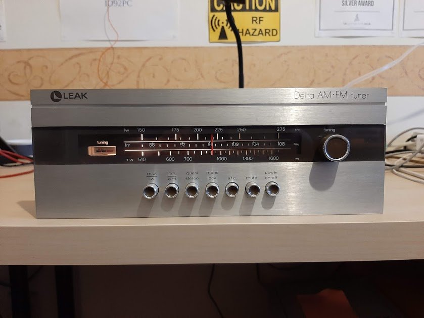

As it's been cold, wet and windy today I investigated why my Leak tuner was apparently not working on Long or Medium Wave (AM) and thus unable to receive Radio 5 Live...
On AM the tuner appeared completely dead...
Leak Delta 30 Tuner
Leak Delta 30 Tuner
This tuner lives in the lounge and feeds my PW Winton stereo amp...
On initial inspection I was mystified why the tuner appeared to have no aerial for LW and MW reception... I'd have expected to see a ferrite rod in there...
Where's the AM aerial?
A look at the service information showed that Leak had been very cunning and arranged that the outer braid (screen) of the VHF/FM aerial coax. feeder would act as the AM aerial :surprise: Once understood it made perfect sense as in its day the VHF/FM aerial would have been a substantial affair lashed to the chimney keeping the TV aerials company and thus would have had a nice long length of coax. down to the tuner and thus a very good AM aerial too...
As I live in an area of very strong VHF/FM signals (the TX is only about 10 miles away on top of a local hill) I'd never bothered with a 'proper' VHF aerial and just used a short length of wire stuck into the centre contact of the aerial socket...
When the tuner was offered a reasonable length of wire connected to the outer of the aerial socket it all worked, albeit a little deaf :)
A little realignment of the AM front-end brought about superb performance :D
More study of the service information shows the tuner has two very unusual features on the AM side: muting (squelch) to supress any audio output when no station is being received at reasonable strength and a dual-gate MOSFET RF amplifier ahead of the AM mixer/local oscillator...
The muting explains why the tuner seemed so dead on AM before I understood the rather unusual AM aerial arrangements...
