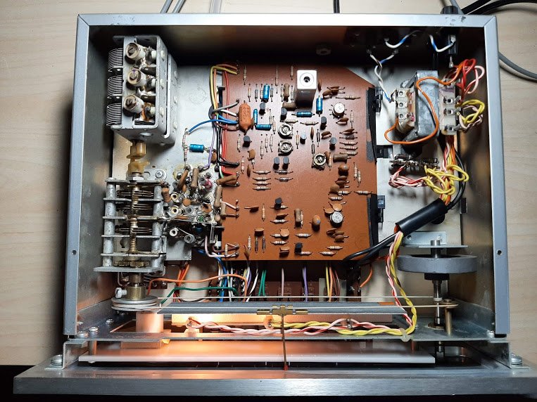

As it's been cold, wet and windy today I investigated why my Leak tuner was apparently not working on Long or Medium Wave (AM) and thus unable to receive Radio 5 Live...
On AM the tuner appeared completely dead...
Leak Delta 30 Tuner
Leak Delta 30 Tuner
This tuner lives in the lounge and feeds my PW Winton stereo amp...
On initial inspection I was mystified why the tuner appeared to have no aerial for LW and MW reception... I'd have expected to see a ferrite rod in there...
Where's the AM aerial?
A look at the service information showed that Leak had been very cunning and arranged that the outer braid (screen) of the VHF/FM aerial coax. feeder would act as the AM aerial :surprise: Once understood it made perfect sense as in its day the VHF/FM aerial would have been a substantial affair lashed to the chimney keeping the TV aerials company and thus would have had a nice long length of coax. down to the tuner and thus a very good AM aerial too...
As I live in an area of very strong VHF/FM signals (the TX is only about 10 miles away on top of a local hill) I'd never bothered with a 'proper' VHF aerial and just used a short length of wire stuck into the centre contact of the aerial socket...
When the tuner was offered a reasonable length of wire connected to the outer of the aerial socket it all worked, albeit a little deaf :)
A little realignment of the AM front-end brought about superb performance :D
More study of the service information shows the tuner has two very unusual features on the AM side: muting (squelch) to supress any audio output when no station is being received at reasonable strength and a dual-gate MOSFET RF amplifier ahead of the AM mixer/local oscillator...
The muting explains why the tuner seemed so dead on AM before I understood the rather unusual AM aerial arrangements...

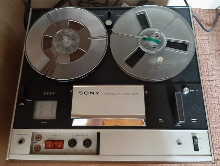

I still regularly use a reel-to-reel tape deck :D
Sony TC-255
Sony TC-255

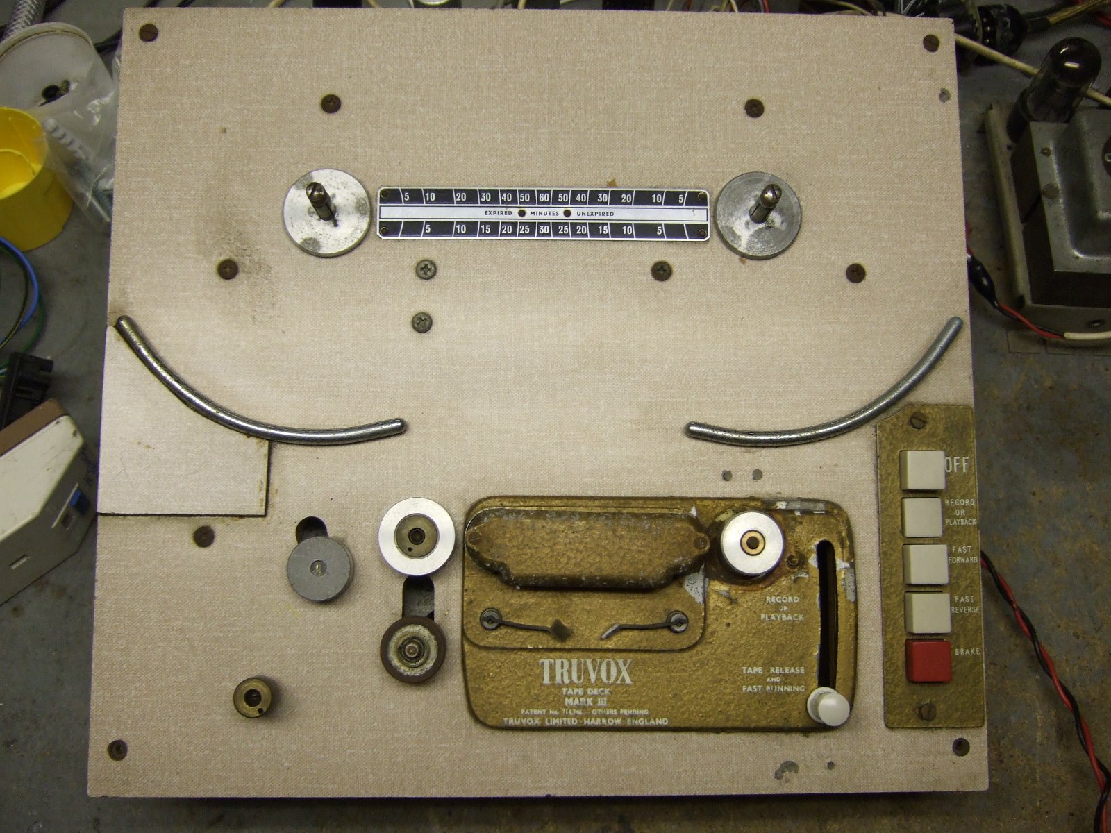

I bought my first tape recorder while I was working up there from one of the previously government surplus stores. I was a Truvox deck + amp + case and speaker. Excellent deck mechanically had separate motors for each spool and capstan, rewound at about 60 mph which was very good unless the tape broke. You had to change the capstan wheels to swap speeds. Not brilliant quality but not bad for the day. I have an almost identical Truvox deck in my workshop which is even older, maybe 50-51.
Never had what you would call a 'professional' machine but the Philips EL3542 was brilliant for the time, 3 speed four track, 15 Khz at 3.75 IPS and 20 Khz at 7.5 IPS. I still have quite a number of tapes recorded on it, mostly David Jacobs 'Pick of the pops.

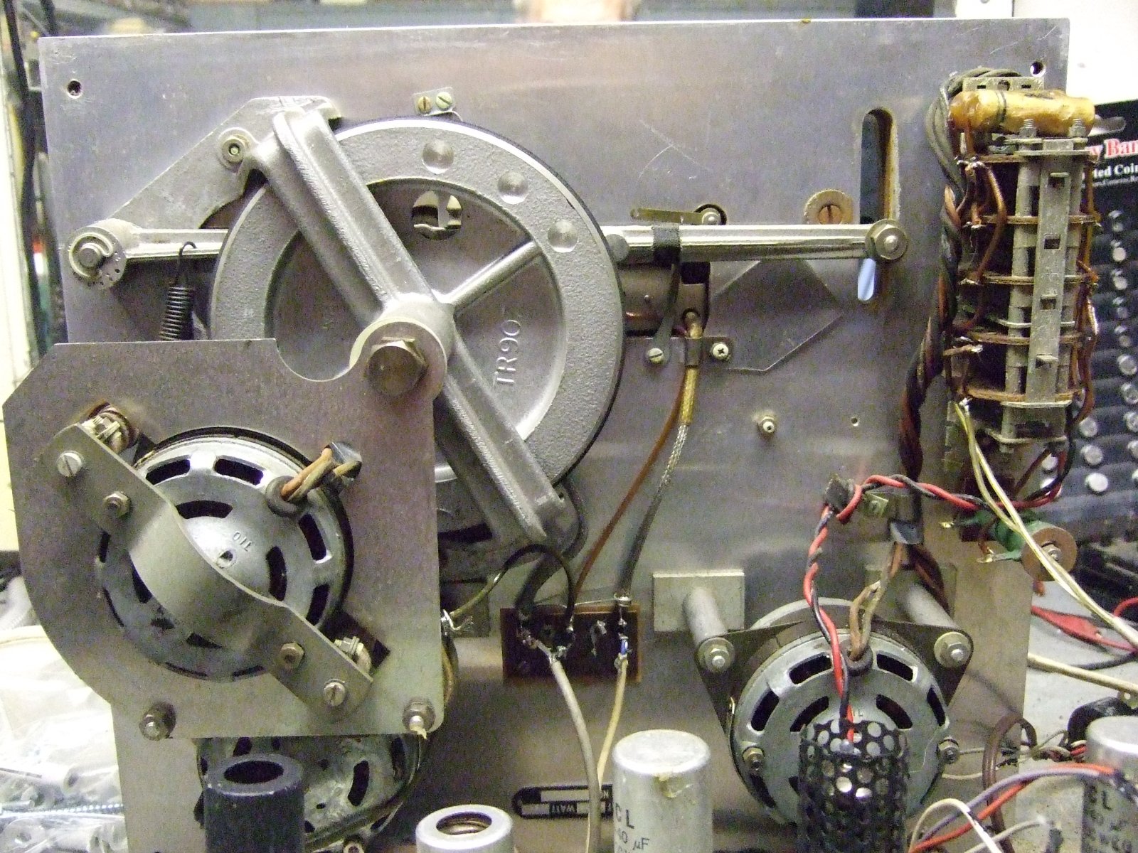

I acquired a Truvox R7 (half-track mono, bi-directional rec/play, 10W valve amp) in 1966, when it burned out its 3-speed inductive capstan motor - a Swedish or Swiss jobby, unhelpfully rated at 220v (and something which I never got round to sorting, but just put in a new motor). That had 3-motor warp-speed rewind, too, Peter!
At the time (late 60s) also had use of a newer mono Truvox R101, and a stereo R102 - VU meters rather than magic-eye - but decent machines.
Years later (late 70s) the R7 was cannibalised to create a stereo deck, with a pair of rec-play boards and VU meters. The troublesome capstan motor (burned out again) was replaced with one from a Ferrograph Series 7, with speed change done by a d.i.y. belt-shift on to the R7's 6-inch diecast flywheel. Even the deck of the R7 ws sturdy: a solid slab of machined-out 6mm aluminium! It was a first, but mechanically unsuccessful, foray into building a stereo tape deck.

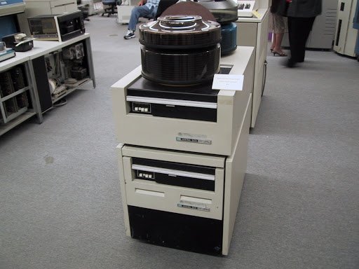

I did have lots of experience of the big CDC cartridge disk drives though... Ones like these:
image from tpsoft.com
Ours were not quite that big... 5-platter disks with a capacity of 80Mb... An in those days that was a serious amount of storage :)
They enjoyed an amazingly fast data transfer rate on their parallel busses. Indeed when they could no longer be supported and had to be replaced by an emulator no current hard disk was fast enough... The emulator was thus formed from fast RAM with a background read/write to a SCSI hard disk...
