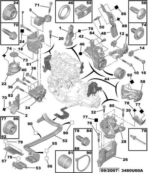

Re: C5 X7 2.2 HDI 173 - rear engine mount/driver shaft mount - part code
Let me know which item numbers you require part numbers for:
(Click Image to Magnify)
thank you Marc for your instant reply, I passed the schematic to my mechanic for confirmation, as far as he described (I wasn't there at the time of investigation) I think is about number 5 and 42.
later edit: mechanic confirmed my assumption, definitely 5 and 42. If 42 is not coming with the rubber I might need number 44 as well.
Ok, so:
Item (5) Anti Torque Link (Right) is part 180674 £78.71
Item (42) Engine mounting Bracket (Right) is part 1807FJ £155.24
All from Citroen direct and VAT inclusive, prices as of today.
