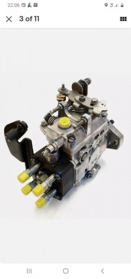

For this car no i dont have, it has the bosch pump, the fast idle cable has like a star wheel on the end of it.

Re: White smoke
Unread post by Jonathancilia »
Exactly as this one

Cold start is on the outside it has a waxstat, today we replaced the fuel filter device and seems to be working better, will report back when car is cold
x 1746
Re: White smoke
OK, if an external waxstat, with puller cable, the cable/lever is adjustable.
When cold, cable pulls tight, and opens throttle a little; when engine warms up, the cable relaxes. Movement is quite small.

Oh i see, at the moment when cold and hot cable stays the same

It has a kind of a spring at the end of it that i think its supposed to be pulled back when cold, so i presume the waxstat is not working
