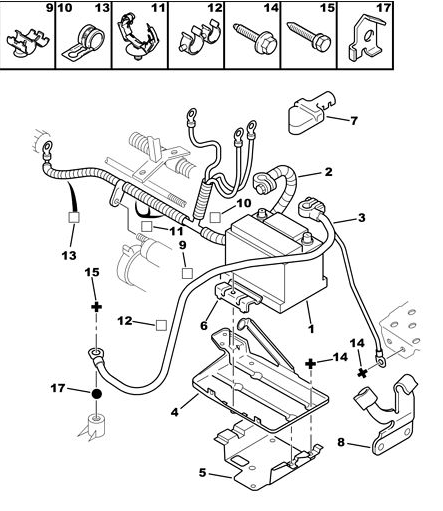

I know there is a thread about this in the super sticky but is there anyway of finding out the original specs, locations of fixing points etc.
The Vin is in my sig but i am looking to get both leads done and just wanted to have some heads up of what to explain to the auto sparky so i do not look like a complete numpty.
I have looked through the sticky thread and would like to go for the modern upto date wire and go bigger in terms of rating just need to work out what the specs are before i start negotiating etc.
Colin
Colin
- x 6945
Re: Xantia Battery Leads Specs
There are no 'specs' Colin apart from the length:
The battery positive cable (2) is 910mm long.
The battery negative cable (3) is 610mm long.
Is this what you wanted?

I just want to make sure i get the job done correctly so the diagram is gold dust for me so i can at least not look like a numpty and give the lengths of both.
From what i picked up in the sticky thread it is possible to run a single + lead from the battery to the starter and then individual leads from the starter to the fuse box?
As for the specs i guess all + battery leads are the same in terms of capacity, old ones were thicker but modern ones thinner but do the same thing.

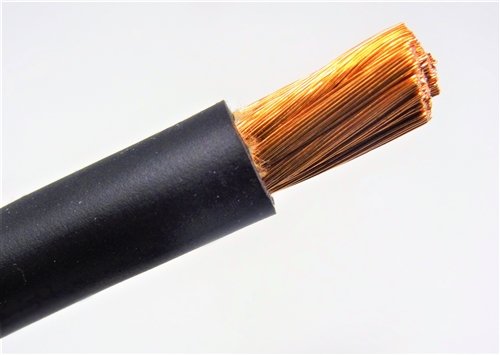

Would suggest using 25mm² stranded welding cable for both Batt+ to starter motor, and Batt? to engine/gearbox Ground, and to bodywork Ground. For that last one (Batt? to body) a smaller cable (10mm² or 16mm²) will be ok. This is usually 'rubber' covered, with hundreds of 0.2mm copper strands, and is very flexible.
25mm² is good for 180A continuous, and 330A+ intermittent [RS figures].
Most decent electrical wholesalers will stock it, and sell by the metre. Some motor factors too.

As Marc kindly posted the lengths of the respective leads and the diagram showing what i shall refer to as branches going to various points it is finally making sense.

Can i just ask 1 more silly question
Are the main earth points the gearbox and the engine ?
I have looked at the diagram posted by Marc and can only see 2 earth points but reading back the info says there are 3 the extra one being the body ?
Sorry for being a numpty but just need to be sure
Colin
Colin
- Posts: 55100
- x 8400
One main big one is on the gearbox Colin...
- x 1746
...and the second one to the body (probably inner wing, under/behind the battery).
Just two in total.
Just two in total.

ksanturion10
- Posts: 228
- Joined: 14 Oct 2018, 21:59
- x 19
...and 3-rd one onto the plate welded to the side of the battery.
There are several wires bolted over it.
