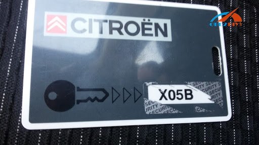

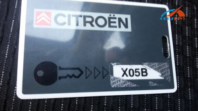

You need the transponder code, have you had a good root through the cars documents to double check you dont have it?
it would have been on a card like this with a scratch off panel.
Alternatively it may have been written down somewhere in the handbook.
