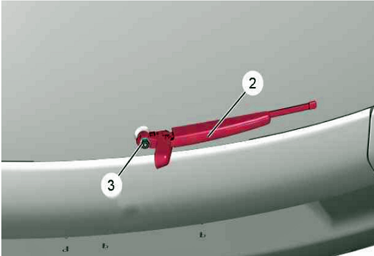

Here you go:
{A} Open the cover (1) (Rear wiper arm (2). | {B} Remove:
{C} Detach the lower trim (5) (as "c") using a peg pliers trim tool [2]. Disconnect the connector (as "b"). Remove the lower lining (5). | {D} Unclip the access hatches (1), (3) ( as "a") using trim removal tools. Remove:
{E} Remove the bolts (4). | {F} Disconnect the connector ( as "b"). Detach the rear screen wiper mechanism (4) ( as "a"). Turn a quarter of a turn the rear screen wiper mechanism (4) (following the arrow). Remove: The rear screen wiper mechanism (4). |
