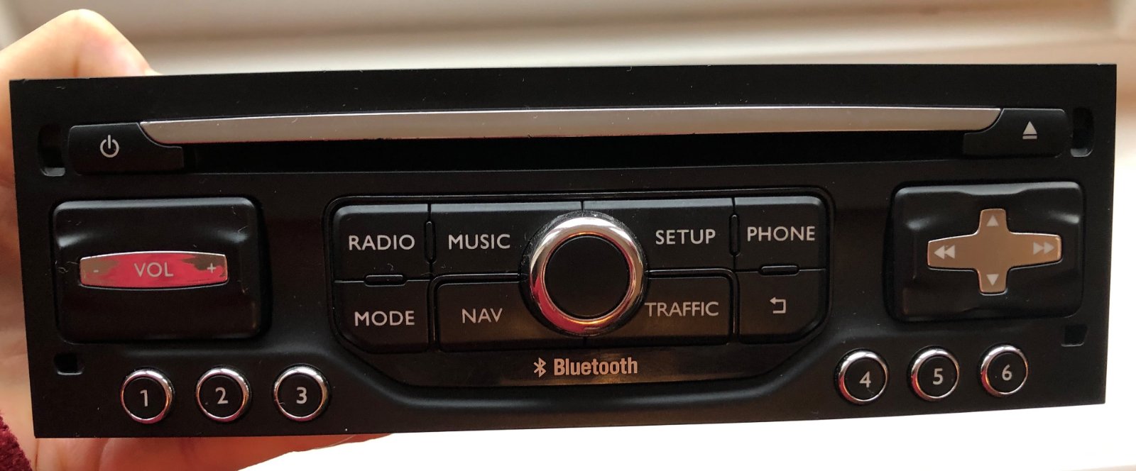

They returned it to me with the CD stuck in it and not fully installed in the dashboard (although still all plugged in). On further inspection, I see that they have also bent and distorted the release clips in the sides of the unit, suggesting that they didn’t use the correct car radio release tool/pins.

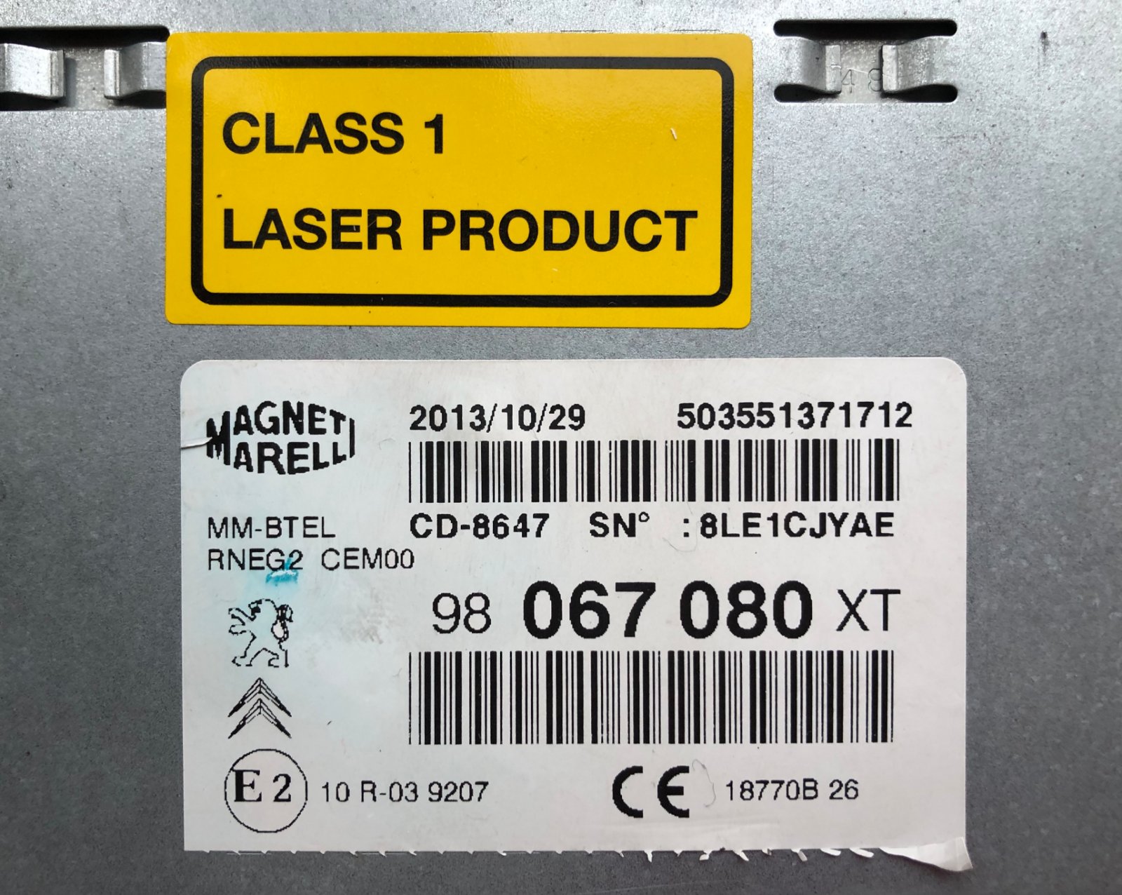

Before the update was carried out:
Unit Reference: 9806708077
CD number 8647
SW Version. - unit RNEG2.75.D.2
They tried the RNEG-RT6 v.2.86 update on USB first, but that didn’t work, so they ordered the CD and that is what crashed the unit.
Photos of the unit are attached.
