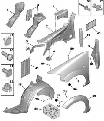

Re: 2007 Citroen C3 1.4i Cool - Fitting a Splash Guard
It’s actually called a wheel housing mud guard, as you can see, item 15:
The studs I referred to are (70).
