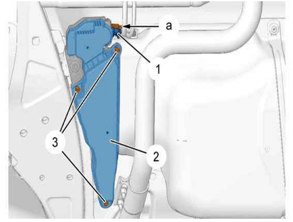

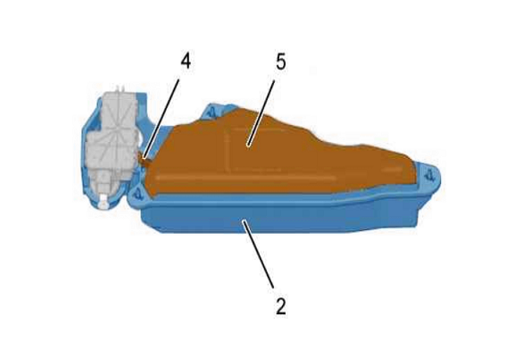

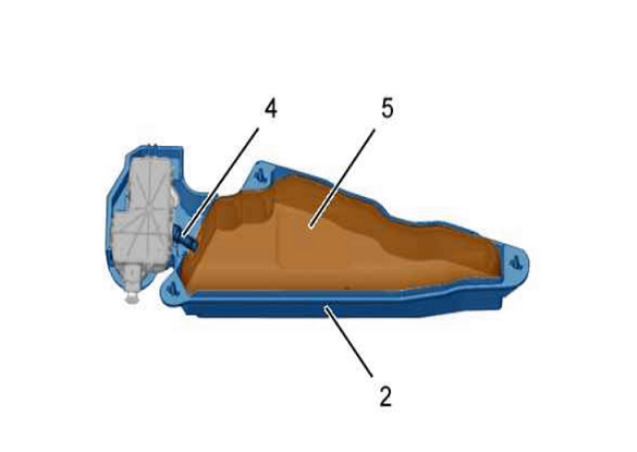

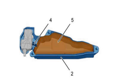

With reference to the DPF Powerflex fluid, Is it easy to change/check the pouch? Where is it in the car? Are there any You Tube vids or instructions/photos available...?
- x 6947
Re: C3 Picasso 1.6hdi MOT Emissions fail....
The additive pouch is contained in a tank next to the fuel tank: Here's the guide for you, but you will need Diagbox or a suitable diagnostic tool to reset the additive counter and prime the system as per the last 2 points:
Tools
ESSENTIAL: Before carrying out any work, put on protective goggles and gloves which are resistant to hydrocarbons.
Refitting
Follow the battery reconnection part of BSI Reset / Battery Disconnect / Reconnect Procedure
CAUTION: Reset the additive counters to zero ; Using the diagnostic equipment.
Perform the actuator test "refilling the pipe: additive pump - additive injector" using a diagnostic tool.

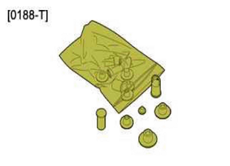

Tools
| Plug Kit |
- Put the vehicle on a hoist.
- Disconnect the battery. (Follow the BSI Reset / Battery Disconnect / Reconnect Procedure)
- Remove the protector under the body (At the rear right) (If necessary).
| CAUTION: Plug the openings using a plug kit. Disconnect:
Remove the lower housing (2) with the flexible reservoir. | Detach the flexible reservoir (5) from the lower housing (2). Uncouple and close the pipe (4). |
| Remove the blanking piece of the pipe (4). Couple the pipe (4) to the flexible reservoir (5). CAUTION: The flexible reservoir (5) must not protrude sideways from the lower housing (2): Risk of damage (On reassembly). Reinsert the flexible reservoir (5) in the lower housing (2). Refit: The lower housing (2). Clip the 3 fixings (3) (quarter-turn). Re-connect the connector (en "a") (/). Remove the Plug Kit. Connect the pipe (1). Refit the underbody protection(At the rear right) (If necessary). |
