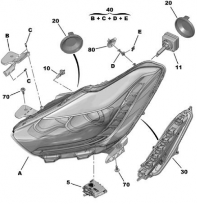

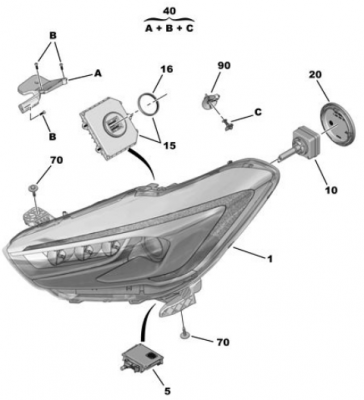

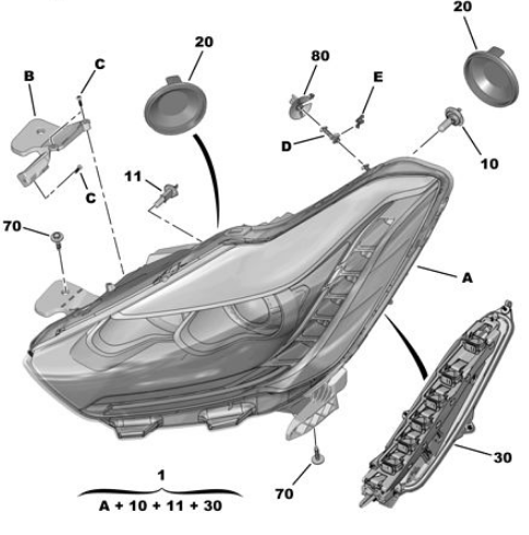

@ greengriff: I've already gone over this in the thread, but to clarify the 3 types of lamp units fitted to the DS5:
Note: Although the first 2 images look the same they are not. The first image shows a projector lens - but this is for a halogen lamp not a D1S discharge bulb. So what you have ordered is for the first image only - not the LED or Discharge lamps!
The Halogen only (image 1) is the cheapest and costs from Citroen about £421
The Discharge and Halogen (Image 2) cost about £1,096
The LED and Discharge (Image 3) are the most expensive at £1,447.
| Halogen Lamps Only (H1 & H7) | Discharge Lamp (D1S) and H1 Halogen | Sealed LED and Discharge (D1S) |
