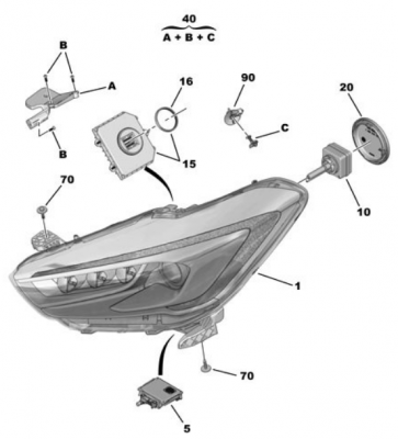

I can confirm that the DS5 has separate headlamp units for right hand drive and left hand drive vehicles. They will need replacing with LHD versions. Bit you also need to be aware that there are various changes and modifications to these over the range, so it is important you get the right ones. Apart from that there are Halogen versions, Xenon directional versions, and then there are the later Xenon with LED versions!
If you pop your VIN up I may be able to help you work out what you have depending on the year. There is no system on these to modify them for different countries - you need the correct ones.

Hi Elaine
Your DS5 does have the later headlamps, that is the ones with LEDs and Xenon's and yes, they are very expensive.
The bare headlamps for driving on the Right hand side of the road - as in France are:
Left Lamp Part number: 1613381080, £1411.76 inc. VAT
Right Lamp Part Number: 1613380980, £1411.76 inc. VAT
I should point out that these lamps above are only for the bare lamp themselves if you were buying them from Citroen / DS. The bulbs and ballast and 'drivers' for the LEDs would likely be separate.
However, this part number should be what you need for locating second hand units - although I expect these to be uncommon....

Thank you, Marc. At least I now have a p/no to work with. So, the question of ballast came up earlier. If I am lucky enough to find the two above p/nos second-hand, do I need to ask for the ballast as well? One of the kind contributors above thought the ballast in my car might work. Gosh, you guys are so technical, puts me to shame!

The ballast you have already will work with the existing and new lamps - there is no difference, as with the driver kit. All the fittings and other parts should be identical - it is just the headlamps themselves you need.elaine wrote: 07 Jan 2021, 16:14 Thank you, Marc. At least I now have a p/no to work with. So, the question of ballast came up earlier. If I am lucky enough to find the two above p/nos second-hand, do I need to ask for the ballast as well? One of the kind contributors above thought the ballast in my car might work. Gosh, you guys are so technical, puts me to shame!
So if you manage to get a set second hand set, they may or may not have the associated parts - that will depend on the breaker. But it won't matter as you already have these parts in your car, so can just swap these over where necessary.

That is an invalid part number - it is too short (should be at least 10), so have a check, but regardless, there is only one set of part numbers for the specific lamps fitted on your DS5.
The different versions have different technologies and can't be modified. The combined Discharge Xenon and LED type lamps have specific operating requirements and dependencies / additional equipment to work and can't be changed for a different system just by swapping the headlamps unfortunately.
The only lamp part numbers are the ones I have quoted above for this specific DS5 build as it was a facelifted model and has different technologies than the previous older models.
