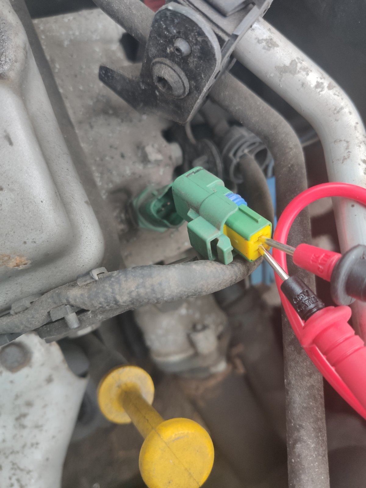

Disconnect the coolant temperature sensor & connect your multimeter across the 2 terminals & switch ignition on, are you getting 5 volts?

Assuming I'm using the tool correctly and it's the correct sensor, I'm getting 0.089
Images attached.

Assuming the ignition is switched on then it looks like the ECU is not powered up. The most likely culprit is the under bonnet fusebox. Next step is to check the power supplies & earths to the ECU.

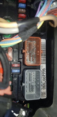

OK Pin 8 is supplied by an internal relay in the fusebox & supplies power to the ECU, assuming that you have confirmed all the fuses are ok then I would say based on perevious experience the fusebox is at fault. You would need to get a bit more involved checking wiring going between the ECU & fusebox to confirm 100% but the fuseboxes are a fairly common failure. The good news is they are not coded so a second hand one can be used but it needs to be from a same spec vehicle.

Have you looked at the bsm fuse box under the bonnet
We have a 207 sw 1.6 hdi.. 179k always started. It has sat a month or so waiting for mot I went out to start it at first do starter turning after flicking the key a few times the starter woke up but wasnt functioning properly. Then after a bit more it did but the engine only spun over.. this has never happened anyway. I opened up the fuse box. Took plugs out and found some lovely corrosion in one of the sockets. I tried to clean it up penetrating oil. Put the plugs back in car started and ran but pas and abs faults came up.. took plug back out broke some pins from corrosion...
Anyway. Found an identical one fitted it car perfect..
A very sad...
