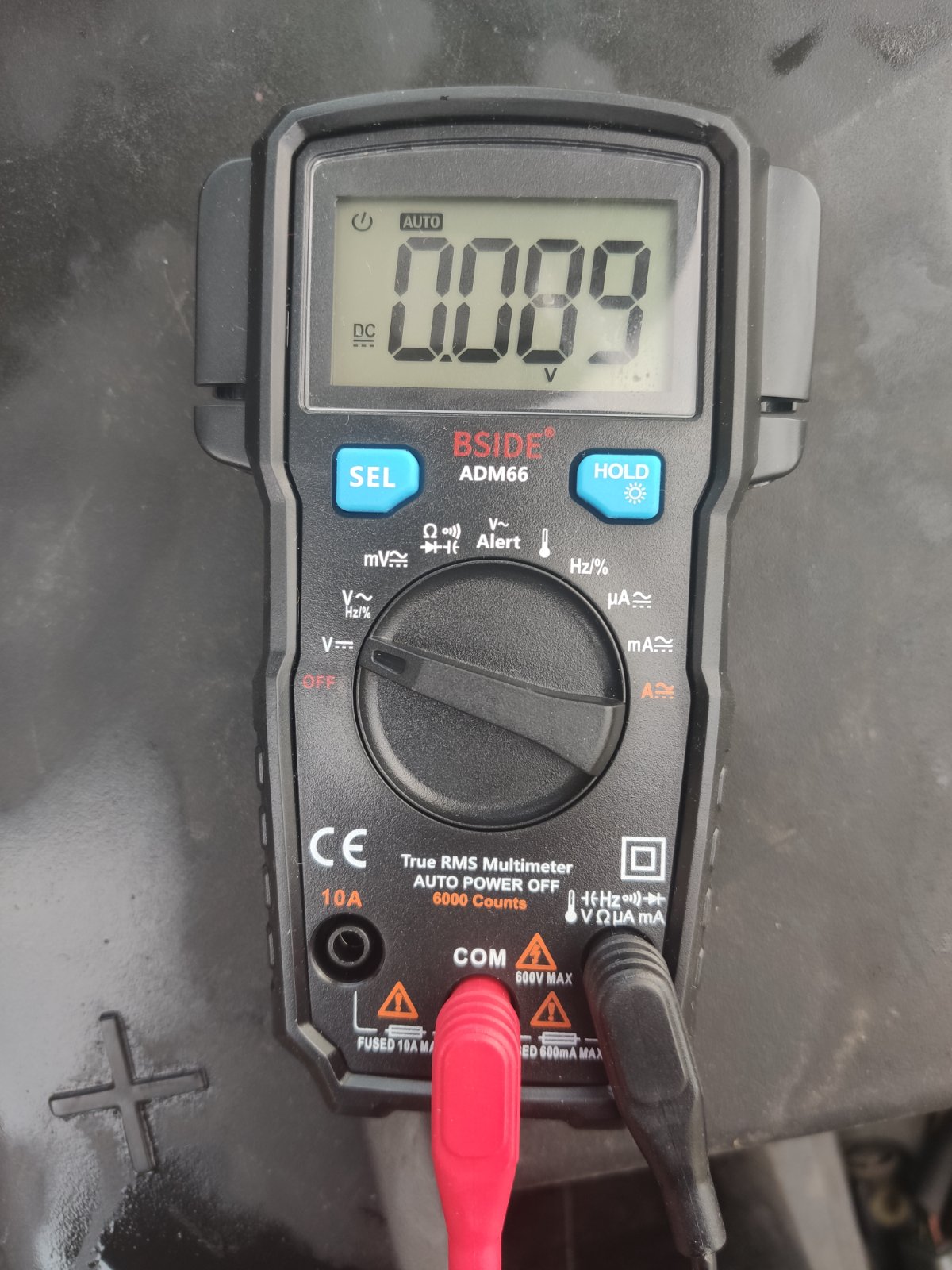

No power to the fuel pump & it sounds like the ECU is not powering up, my first thoughts would be an under bonnet fusebox fault.
Disconnect the coolant temperature sensor & connect your multimeter across the 2 terminals & switch ignition on, are you getting 5 volts?
Eco mode is not a fault, its a power saving feature, the car will come out of eco mode when the engine is started.

Assuming I'm using the tool correctly and it's the correct sensor, I'm getting 0.089
Images attached.
Images attached.
Re: Replaced ECU, BSI and new key. Sill not starting, RAC says no comms from diagnostic port. Possible wiring issue.
Assuming the ignition is switched on then it looks like the ECU is not powered up. The most likely culprit is the under bonnet fusebox. Next step is to check the power supplies & earths to the ECU.
OK, Check for ignition live supplies on pin 12 of the 16 way green connector o the under bonnet fuse box and pin 8 of the 16 way black connector
If you have no power at pin 12 of the 16 way green check for power at fuse 4.

I have power on the green connector but nothing on black connector
Can you recheck the black plug again but when the engine is cranking
- Posts: 10
- Joined: 31 Dec 2020, 00:26
- Location: Fleet Hampshire
- My Cars: 206 1.1 2005
Tried while cranking and still nothing (well it showed something like 0.7)
OK Pin 8 is supplied by an internal relay in the fusebox & supplies power to the ECU, assuming that you have confirmed all the fuses are ok then I would say based on perevious experience the fusebox is at fault. You would need to get a bit more involved checking wiring going between the ECU & fusebox to confirm 100% but the fuseboxes are a fairly common failure. The good news is they are not coded so a second hand one can be used but it needs to be from a same spec vehicle.
