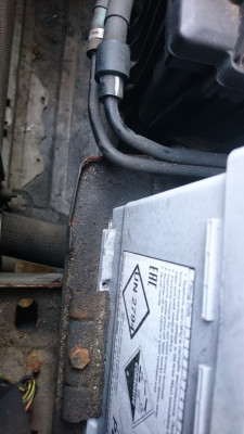

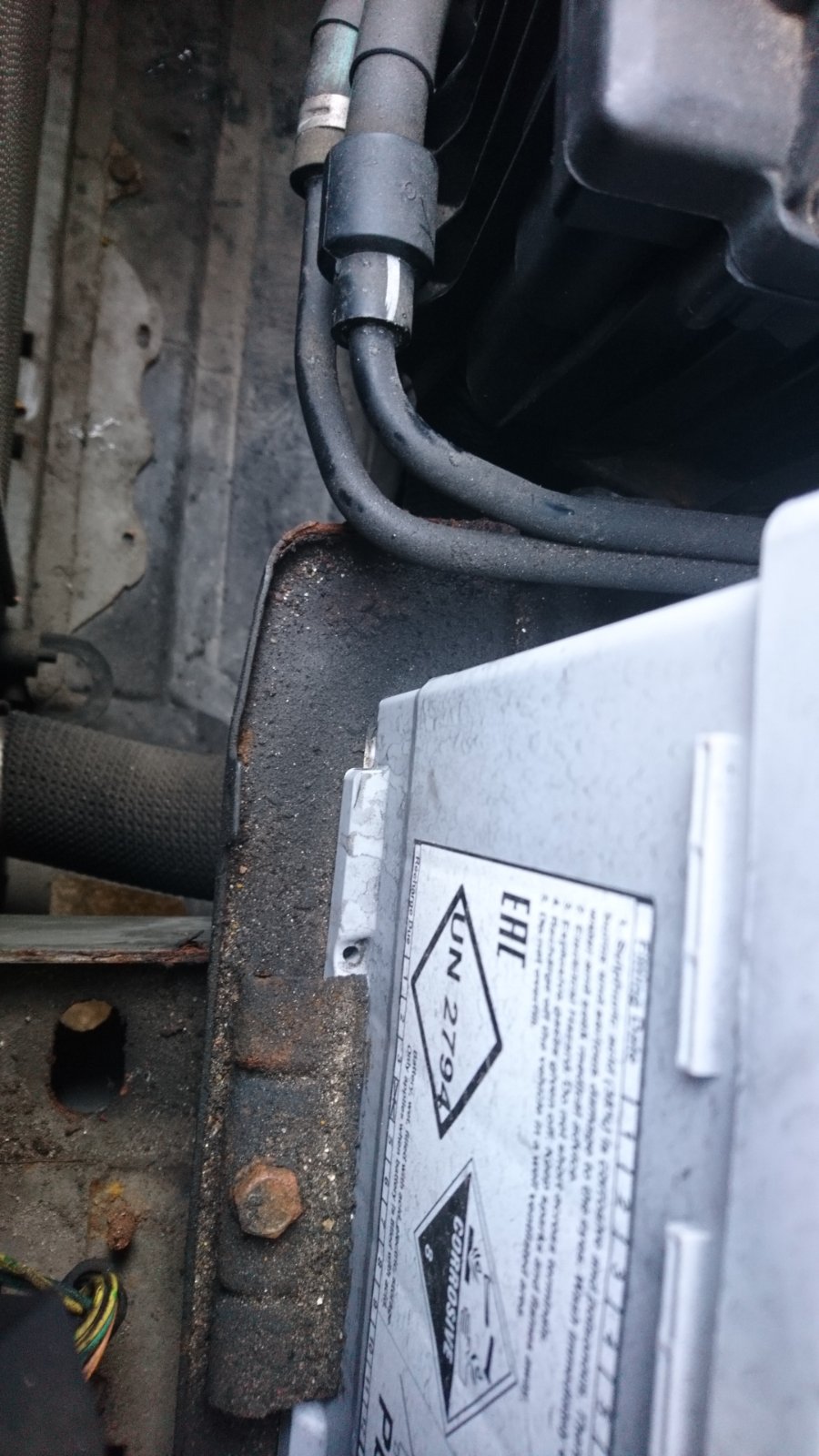

Not sure about the kinked pipe will take a look at mine in moment and take some pics.
However the amount of LHM under the car reminds me of what happens when you overfill the reservoir and when you do down/up cycles the fluid returns to the reservoir and when it over flows out it runs out in front of the bulkhead and onto the subframe and then runs everywhere .

Not sure if i have taken the angle but the pipes shown are metal pipes, i cannot see any join that links in with kinked pipe

admiral51 wrote: 30 Dec 2020, 12:59 Image
I think on v6 model they are a bit different.because of a power steering pressure regulator, I think, but I appreciate you taking the time to take the pictures

Looking at the pictures again, and it being a metal pipe "T" that the kinked pipe is attached to is it possible that the original pipe would have run along the bottom edge of the battery tray and also have been metal.
Unless the replacement pipe has an elbow in it then it will kink again ?
Maybe worth a punt at someone like Hyphose to see if they can make up a pipe to length with the required bend.

Mike i have looked again at the kinked pipe and its routeing and i may have been a little hasty.
If you look closely you can see where the replacement pipe sits over the original ( factory ) pipe work both ends.
Would it be more logical that the pipe work ran in a similar route to the one that is still in situ, ie angles towards the front of the car and then down not as i first guessed along the battery tray.
Where the original pipe has been cut would have been down to who cut it and the access they had to make a temp repair.
I do not think it will be that difficult for someone with the right knowledge and equipment to manufacture a decent and more permanent repair as it looks like there is a fair bit of original pipe work both ends to play with ?
