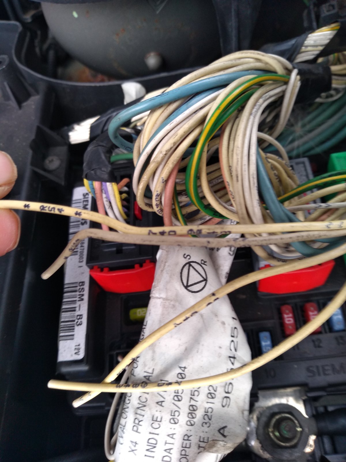

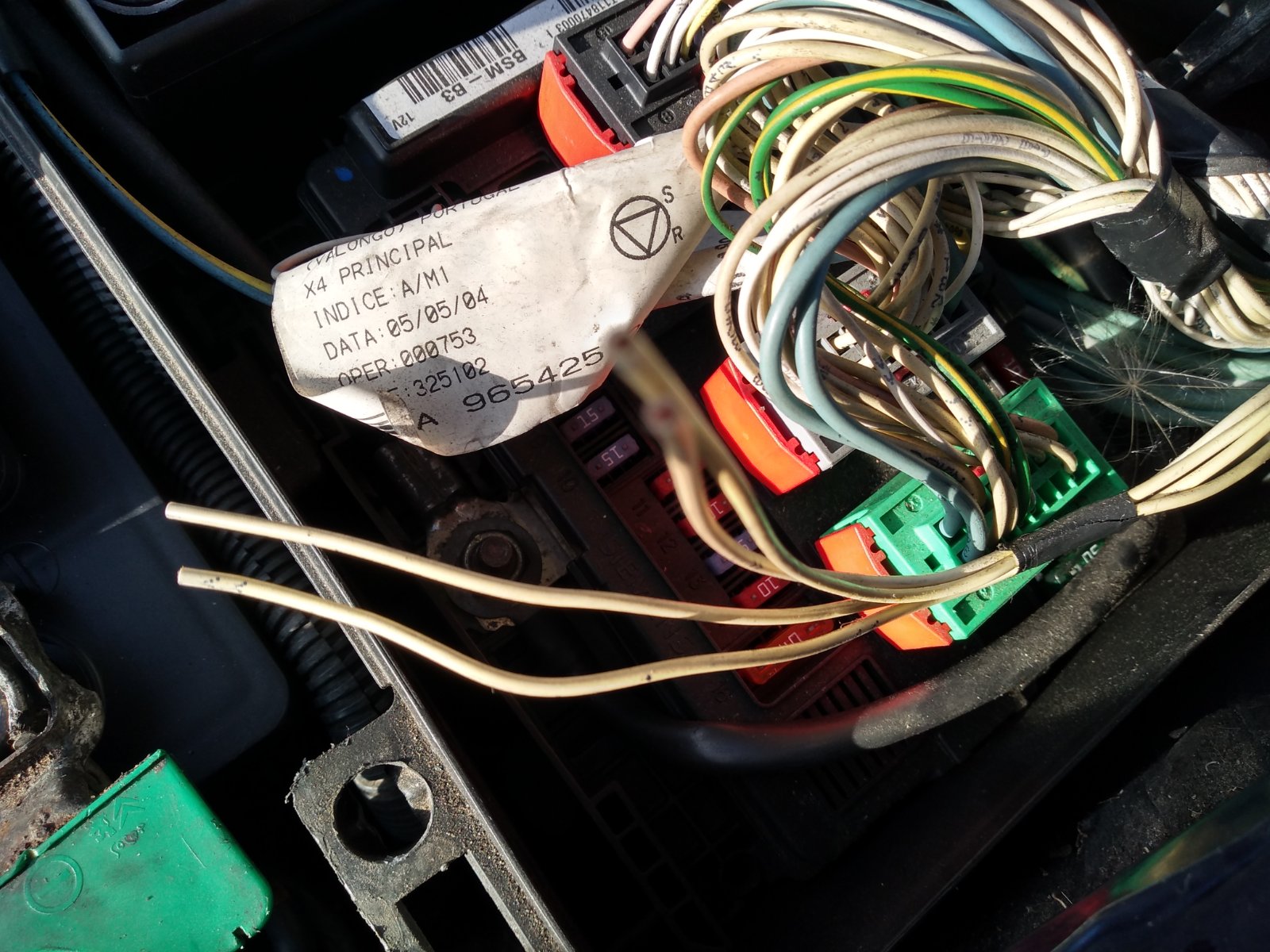

well found 4 white wires as saidtake a look at pics and there all white so thats gonna be fun lol

Thats the ones. Have you found the other ends inside yet?
Its not hard to work out which is which, either set your meter to ohms & check which ones have continuity. Or connect one to the battery (making sure the ones at the other end are not touching anything) and then check which one has 12v.

update had a look at wiring yes its got numbers take look at photos so nearly there be more soon

Just match the codes up at the BSI end inside, I would still always confirm with a meter though.
