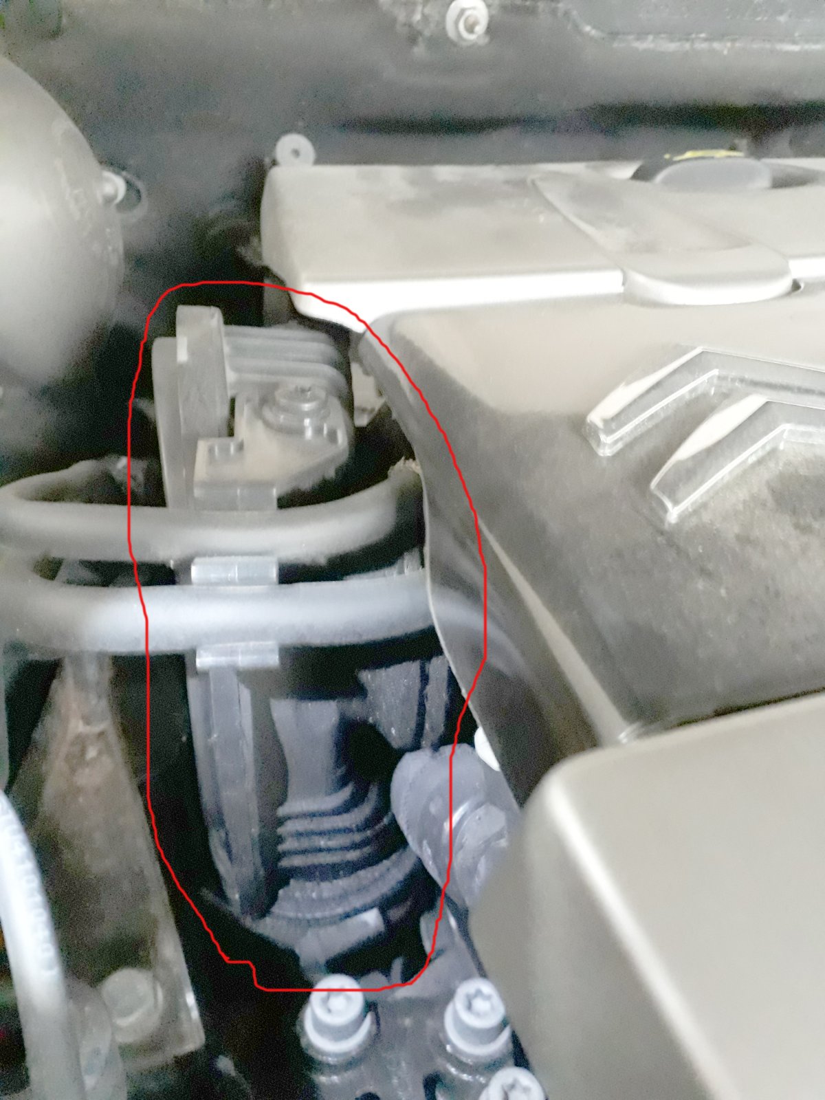

What part is the one circled in red? It has a slight oil leak which dried up (3.0 V6 HDi engine).

That's the Inlet Airflow Calming Housing, part of the Turbo air piping.

is a little oil leak as in the picture expected to be found there?
any chance you got the oem code? or can point me where to find it in citroen service?

It's under 'Turbocharging', 'Turbo Air Piping' if you have your own access. As we have to pay Citroen, I can really only provide live data part numbers / diagrams for members making a £10 min Forum contribution that will cover you for up to 2 years of parts enquiries - see below for more info if you need assistance:
A response to your question by a Forum Admin will require detailed vehicle information that requires you to have made a current contribution to the Forum.
