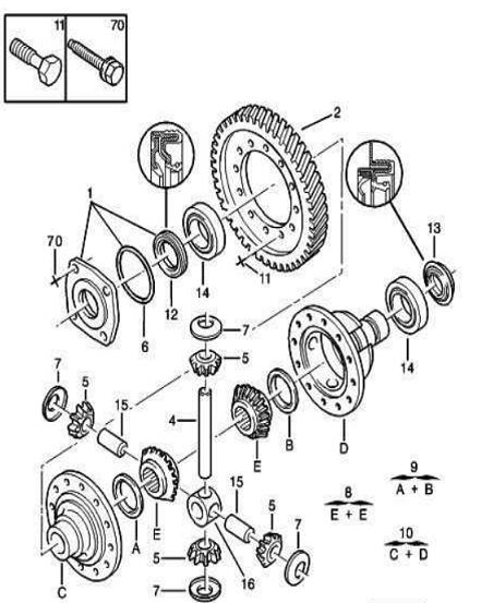

Ok, so this is what I have on the ML5T Box as fitted to the early Relay in case it's of any use:
  • Manual transverse gearbox with 5 forward gears and one reverse gear:
  • Torque transmitted: 30 m.daN
  • Primary and secondary shafts: Type MG
  • Synchronizers: Type MG
  • Cone synchronizer driven by 3 studs with double friction surface
  • New internal speed control
  • New reverse gear brake control
  • Device preventing reverse gear being selected from 5th gear
  • Differential unit containing 4 planet wheels (utility vehicle)
Identification
" a" Identification plate of gearbox .
" b" location of engraving of serial and gearbox numbers.
Designation:
(1) input shaft
(2) release bearing guide
(3) clutch housing
(4) gearbox casing
(5) oil tube spout
(6) primary shaft bearing clearance adjustment shim
(7) driving gear
(8) output shaft
(9) driven gear (1st gear)
(10) planet wheels
(11) speedometer pinion
(12) speedometer drive gear
(13) sun wheels
(14) differential box
(15) differential crown wheel
(16) differential bearing retaining plate
(17) 1st/2nd synchronizer and reverse driven gear
(18) driven gear (2nd gear)
(19) driven gear (3rd gear)
(20) 3rd/4th synchronizer
(21) driven gear (4th gear)
(22) driven gear (5th gear)
(23) synchronizer (5th gear)
(24) sun wheel adjustment shim
Application
Engine typeGearbox reference
Legislation typeCodeStandard tyresTyres on option
RFWXU10J2U20 LE 2120 LE 37
DJYXUD9AU20 LE 2120 LE 37
DHXXUD9UTF20 LE 2020 LE 36
T9ADJ520 LE 1920 LE 35
T9ADJ5 chronospeedometer option20 LE 5220 LE 54
Data
Gearbox reference12345Reverse gearcrown wheel and pinionSpeedometer drive gearSpeedometer drive gear
20 LE 1911x4118x3528x3541x3749x3313x26x4113x7325x20(plastic)
20 LE 2011x4123x4131x3740x3549x3313x26x4114x7525x20(plastic)
20 LE 2111x4123x4127x3732x3143x3313x26x4113x7325x20(plastic)
20 LE 3511x4118x3528x3541x3749x3313x26x4113x7326x20(plastic)
20 LE 3611x4123x4131x3740x3549x3313x26x4114x7526x20(plastic)
20 LE 3711x4123x4127x3732x3143x3313x26x4113x7326x20(plastic)
20 LE 5211x4118x3528x3541x3749x3313x26x4113x7325x20(steel)
20 LE 5411x4118x3528x3541x3749x3313x26x4113x7326x20(steel)
Lubrication
Capacity1,85 litre
Oil qualityRefer to the Manufacturer’s recommendations
Check the oil levelOil level plug
Drain and refillThe gearbox is lubricated for life
Tightening Torques
ReferenceDesignationNumberM.daN torque
25Reverse lamp switch12,5
26Gearbox and clutch housing fixings132
27Speedometer drive support11,5
28Oil level plug13
29gearbox drain plug13
30Differential bearing locking plate screw42
315th gear cover screw52
32Differential housing fixings (screws M8)72
33Differential housing fixings (screws M10)62
34secondary shaft nut117
35Gear control bracket screw61,5
36differential gearwheel screw127,5
37Bearing retaining plate screw22
38Fork securing bolts (5th gear)12,5
Special features
Reverse gear brake
The reverse gear brake is used to reduce the rotational speed of the primary shaft quickly, then stop it when reverse gear is selected.
When changing from 5th gear, a locking pin moves to prevent reverse gear from being selected.
The primary and secondary shafts are of MG type.
Synchronizers
The synchronizers are of MG type (new generation Borg Warner).
1st/2nd gear synchronizer: Double synchronizer with single cone and integrated ball bearings.
3rd/4th synchronizer: Double synchronizer with single cone and integrated ball bearings.
5th gear synchronizer: Single synchronizer with integrated ball bearings (on the primary shaft).
This is the old Parts Diagram for this Gearbox:
