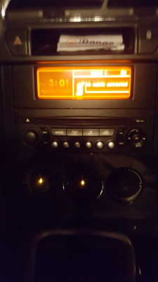

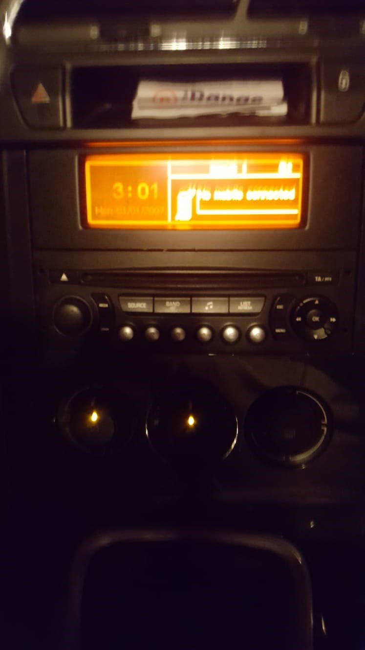

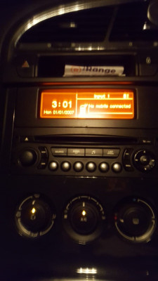

Not sure about posting the VIN. I'd say definitely no mute button.
x 6958
Re: Rd4 not answering phone calls
Read my post - the VIN is masked. The pictures won't help me regarding a hands free kit which is why we need the VIN. The hands free kit if fitted will be hidden in the dash - hence the reason we ask for the the VIN.
