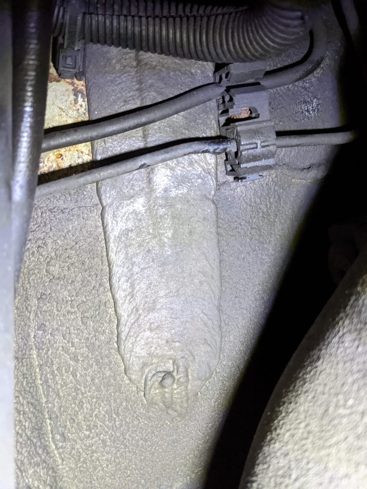

So I'm fixing a punctured rear hydraulics return line (already got some compression fittings for the PE-line) when I have a closer look and see some corrosion on the rear hydraulics supply line ...
upper line: return piping, lower line: hydraulic line. The shiny part isnt leaking oil, I just cleaned it up a bit to see better.
I didn't dare to scrape away the corrosion in order not to further damage the line, on the other hand I think that if the line was just held together by rust the high pressure on the supply piping would already have burst it. What am I going to to next? I was thinking scraping away the rust, use some penetrant conservant (fluid film a) an seal it up with some cable grease. Any assesment on how much of a good or bad idea that is?
I'm doing all the work in my driveway on ramps so I am not too keen on changing the whoe supply line, also probably citroen is going to charge an arm and a leg if its available at all ..

Have a look at my thread re this pipe burst when in the highest setting and dumped most of the LDS fluid onto the ground.
viewtopic.php?t=66453
It is relatively easy to fix if you have the correct materials and tools. It looks as though your isn't rusted through yet but when the high pressure side goes the fluid will come out rather quickly. my hole was the size of a pin head. I didn't realise it was hole in the pipe until it dropped right down at the back.
