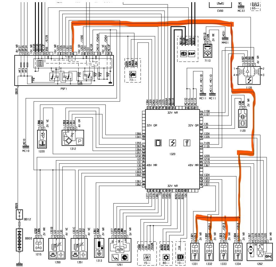

There is no 5v side on the injectors, one side is 12v with the ignition on (some vehicles need to start cranking before the power goes to the injectors) the other pin is a switched earth from the ECU.

Ok, so i shouldnt have had 5v, i only checked the outside 2 injectors as the inner two are a pain to disconnect, the inner two include the one that is fueling so hopefully i am going to find 12v on that and 5v on the last of the 3 that dont provide fuel , at least then i have something to work on, roll on tomorrow.

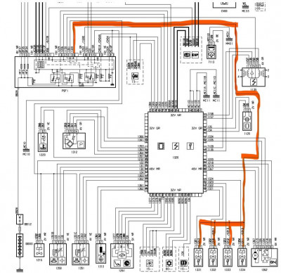

So pin 2 is the live supply to the injectors this comes from the internal injection relay in the under bonnet fusebox out via pin 16 of the 16 way black connector. If you look at the diagram you can see that this same internal relay also powers the igniton coil out from pin 9 of the same plug. The easiest place to start would be the fusebox. The injectors harness is a small harness on its own connected to the main engine harness by a 6 way plug behind the inlet manifold, this too would be worth a look.

Thanks for that, i did disconnect the plug behind manifold today and took out injector harness to test for continuity and resistance on the shared feed and signal wires and then from plug to fuse board on live and plug to ecu on signal wires, going to recheck it all again tomorrow, now i have a bit more info
