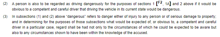

No you aren't.GiveMeABreak wrote: ↑24 Nov 2020, 11:21 You are allowed to drive the car to and from a garage for work to be done - BUT you will have to prove this if stopped - so you'll need to have an appointment / officially booked it in at a garage first.
You are presumably misstating the specific exemption to MOT requirement provided by Paragraph 6(2)(a)(iii) The Motor Vehicles (Tests) Regulations 1981, which is limited to taking the vehicle for work to remedy MOT fail defects.
In this case, the work isn't to remedy an MOT fail defect, so that exemption doesn't apply. Note 'examination' refers specifically to an MOT.
OP could perhaps take car for an MOT on assumption it will fail on the steering alignment, at which time it seems that it would be permissible to drive the car elsewhere for alignment work. But, even then it is arguable that driving the car with the steering alignment so far out would constitute dangerous driving within the meaning of Section 2A Road Traffic Act 1988:

Re: Citroen C5 steering wheel alignment
You can if you have pre-booked and also despite what has been said above, the UK GOV website makes it clear:
The last bit in red is relevant in this case, but as long as it does not have a major defect and is dangerous - or you could still be fined.Retest after a repair
In some cases your vehicle can have a partial retest for free or a reduced MOT fee.
Leaving your vehicle for repair
You only need a partial retest if you leave the vehicle at the test centre for repair and it’s retested within 10 working days. There’s no fee for this.
Taking your vehicle away for repairs
You can take your vehicle away if your MOT certificate is still valid.
If your MOT has run out you can take your vehicle to:
- have the failed defects fixed
- a pre-arranged MOT test appointment
