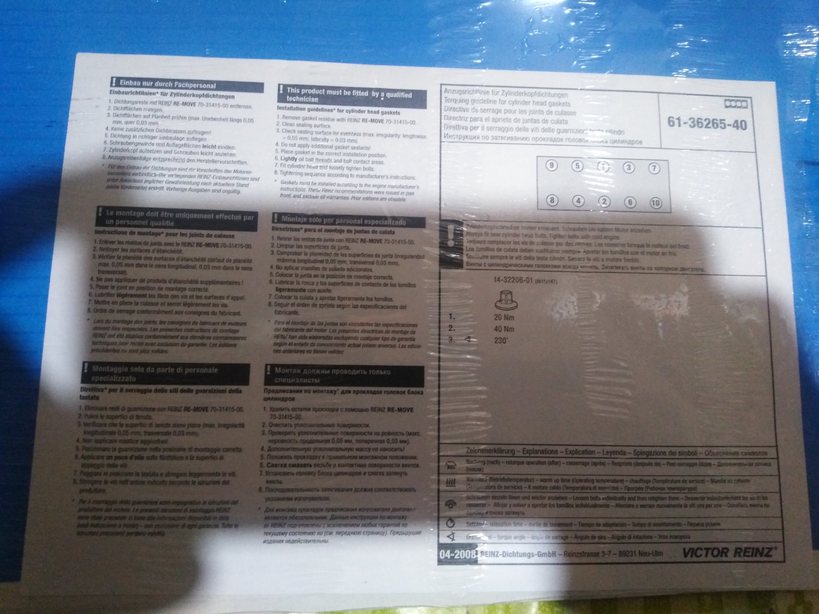

Would anyone be able to help me out with finding the torque settings for the cylinder head? I have tried a google search but cannot seem to get a common answer. Any help would be appreciated, thanks.

Values ??from the program tolerance data-20Nm 40Nm 260'.I think it should go in 4 phases 20,40,130 '130'.There is a possibility that the head gasket is accompanied by instructions for tightening torque.
petarc1971
Posts: 61
Joined: 01 Mar 2019, 19:50
x 10
Re: Timing Belt Failure on a 2013 Peugeot Partner 1.6 HDI
Unread post by petarc1971 »
I just bought a gasket for my peugeot and the data matches the data from the data tolerance.
