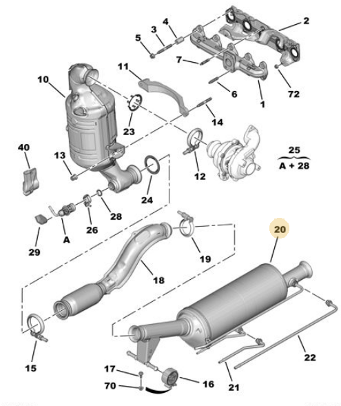

Hi Tom, no problems - before you do anything - did I mention that your vehicle is being flagged up as subject to an after sales campaign? If I haven't mentioned it already, do ring the dealer up and provide your VIN to them - they will tell you what the work involves, but it will be free of charge.
As for the info you wanted:
The particle filter is designed for the mileage you state - but can't factor in the specific driving conditions, so is an average scenario I suspect. You may well get more life out of it yet - just keep an eye out on the 'Risk of Clogging' message.
As for the parts:
The particle filter is item (20)
You have several options from Peugeot - an OEM original filter or an exchange version, so I'll list both with prices for you:
Peugeot New DPF: 1611904280 £969.14
Peugeot Exchange DPF: 1611904780 £798.61
Both these have a refundable surcharge when they receive your old one back of £186.
All prices from Peugeot, correct as at time of this post.
As for the parts:
Tom309
- Posts: 75
- Joined: 22 Nov 2020, 20:41
- x 13
Re: Eolys
Thanks again, that was fast.
The diagram is disappointing, it looks like the filter can't be split for cleaning, but I'll have a peer under the heatshield in daylight just in case...
There is one recall for software due to NOx, was going to take it in after Covid, but it has carried on much longer than I thought.

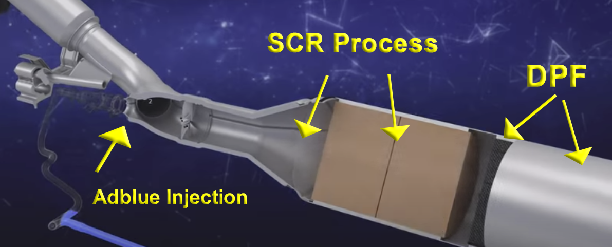

No problem. It may be related to the SCR, but from experience of other members with this engine, it may be injector-related, so I would still give them a call as soon as you are able.
- x 6960
Tom309
- Posts: 75
- x 13
Re: Eolys
Hi Marc,
Thanks for that, I had wondered what happened to the add blue. Interesting about the after sales campaign, I will get the car booked-in and see what they say.
