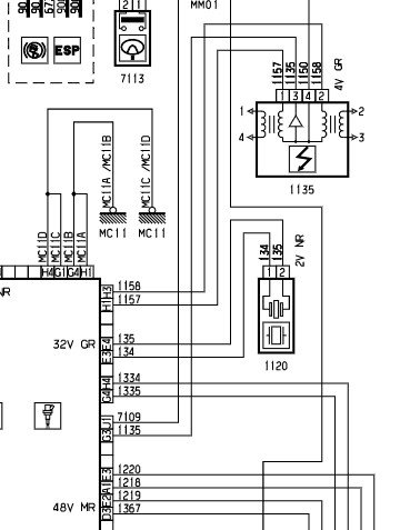

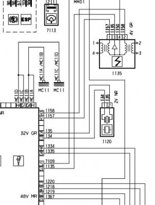

What is the last 8 digits of VIN & i will look at a diagram & tell you what pins to check.
Economy mode is not a problem & is not causing the non starting issue, the car will come out of eco mode once you get it started. It’s doing what its meant to do at the moment.
vincentfishing
- Posts: 126
- Joined: 13 Nov 2020, 16:03
- x 13
Re: bought a 2008 xsara picasso 1.6vtx 16v non starter cheap
Thanks
25999703 (last eight)
wheeler
- Posts: 7932
- Joined: 21 Sep 2002, 19:07
- x 1056
OK so pin 4 is the power supply from the BSM, this should have battery voltage at it when the ignition is on or when cranking, Pin 1 is the trigger for the cylinders 1 & 4 part of the coil, Pin 2 it the trigger for cylinders 2 & 3 part of the coil.
Pin 3 appears to be a feed back to the ECU to show the coil is powered up, i would say it should be a constant 12v when cranking.
Connecting the noid light between pin 4 & 1 then 4 & 2 should have a pulse on crank.
Check Each injector plug. If you are getting the pulsing at the injectors & coil i would check the timing.
I have never really found resistance checking to be a good indicator of coil condition.
