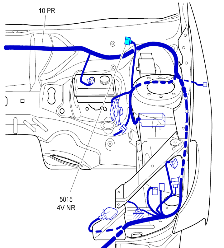

Ok, so the wiper motor has 4 pins
Pin 1 is the Earth
Pin 2 (503) To the BSI - Engine fixed stop command
Pin 3 (500) To the Engine Fuse Box - Low speed motor command
Pin 4 (501) To the Engine Fuse Box - High speed motor command.
So I suspect it is your engine fuse box that is playing up as it is this that controls the power to and from the motor and the internal relays are non-user serviceable to be realistic.
Here's the harness concerned from the wiper motor to the engine fuse box (click image to magnify). 5015 is the wiper motor, 10 PR is the harness.
Pin 1 is the Earth
