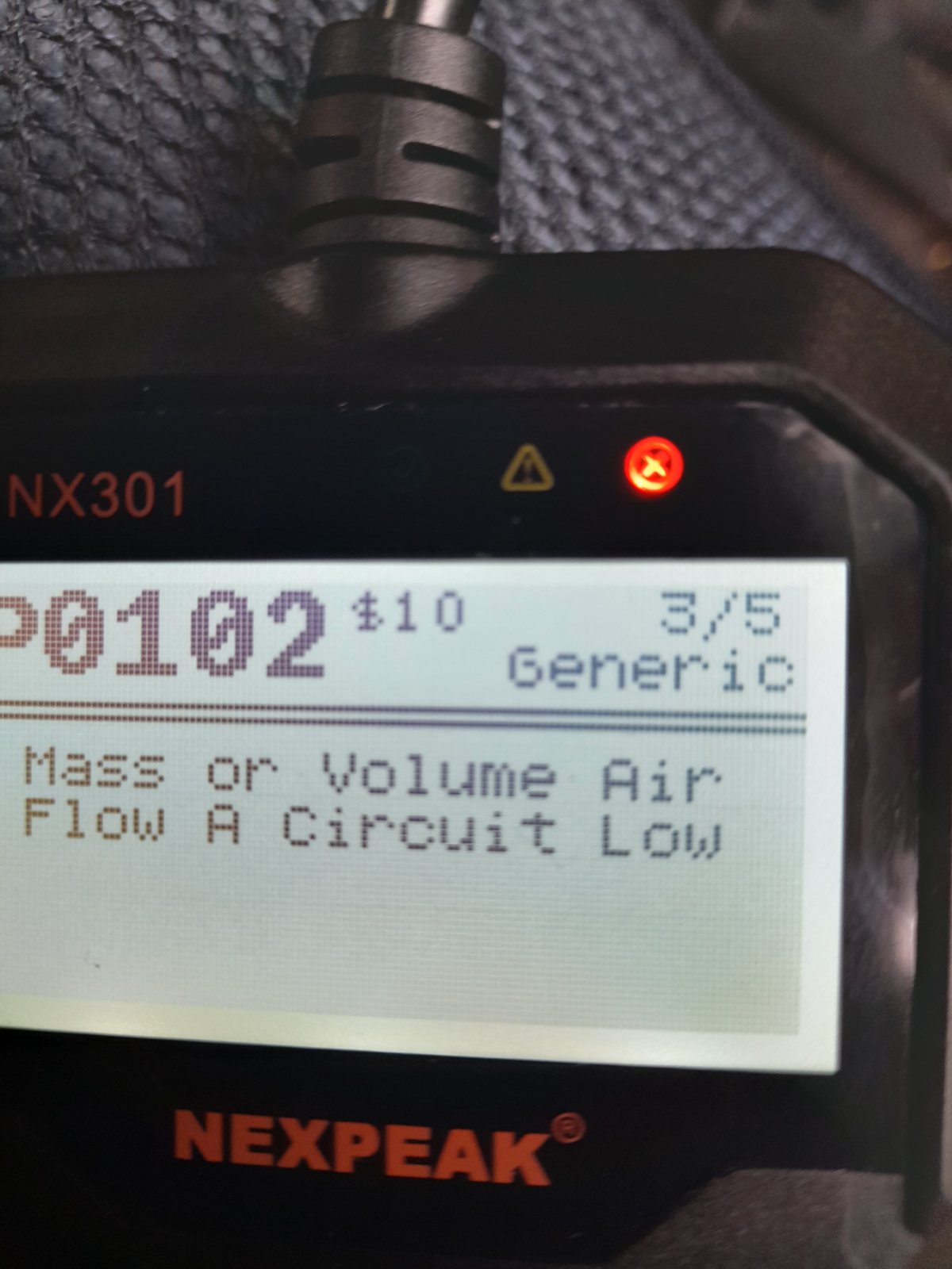

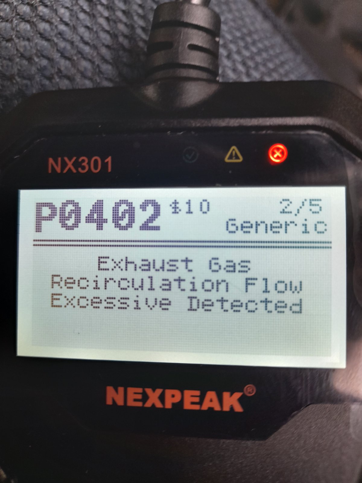

Hello all. I posted recently about my 2005 2ltr hdi Berlingo Multispace losing power. It still runs okay when this happens but wont go above 3000 revs. A local garage told me it was the maf sensor, so I replaced it. It was fine...for half a day then the problem returned. A mate then plugged in his diagnostic machine and it brought up 5 faults. I am including pics of them. My question is; do you think this will be an expensive fix? It has been a great car and is now approaching 140k miles. Much as I like it, I dont want to be spending hundreds of pounds on it. I would really appreciate any advice. Thanks in advance. Tony.

OK so both the EGR & MAF faults can go hand in hand with each other, There is no feedback sensor on the EGR on this engine so it uses the MAF (not very well admittedly) to know what the air flow is doing.
Was it a branded MAF or a euro car parts special?
Does your fault reader have a live data function? this would be my first step to diagnosing this problem.
Get the engine running for at least 10 minutes then let it idle what airflow reading are you getting? after you have that have it idling & watch the airflow reading when you pull the vacuum pipe off the EGR valve, what does the reading change to?
Are you getting any smoke from the exhaust?
