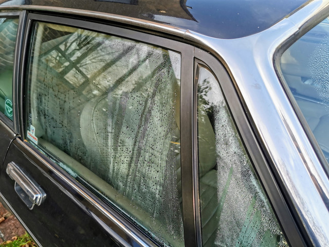

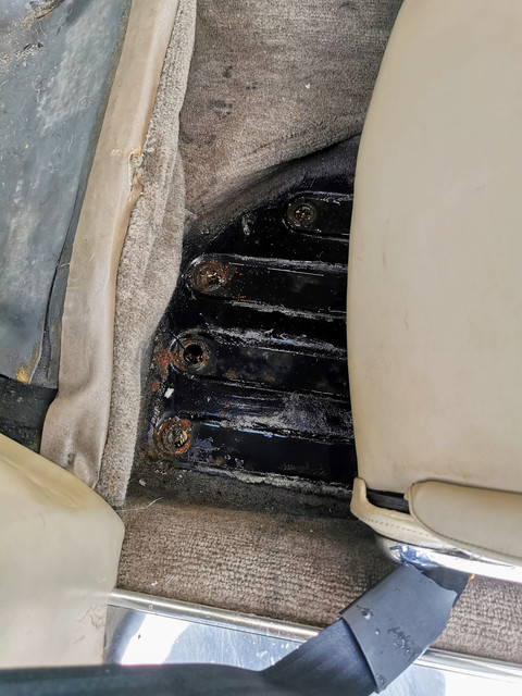

Biggest urgent item is to try to stop the Jag filling up with water.
This has been a pretty sunny day, it's obvious there's standing water in there.

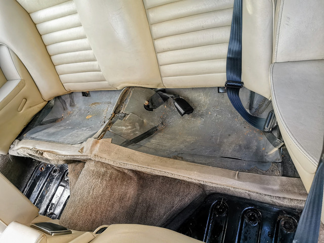

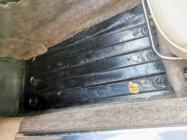

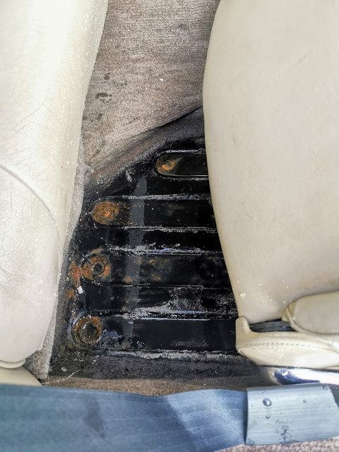

While I had already pulled the front carpet out on the offside I'd not touched the rear.
Oops.
Yep... that's been holding on to a bit of water.
I punched out the bungs in that vicinity to allow the water to drain from the car for now.

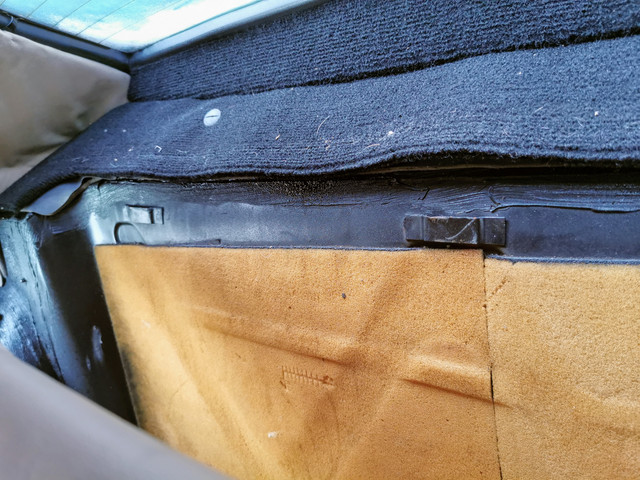

I wanted to take a closer look at the rear to make sure we didn't have significant amounts of water getting in through the rear window so pulled out the rear seat. I know there can be issues with these cars where water can pool under the rear seats if the rear window leaks.
While I did find large amounts of dog hair, aside from a little condensation there was no water to be found happily.
The nearside carpets were slightly damp but not actually hiding standing water.
I've removed them from the car to be taken inside and thoroughly dried out for now.

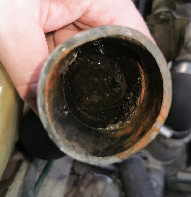

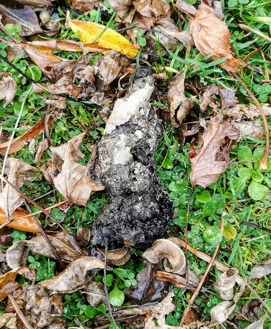

One of the main areas I knew water was getting in was via the heater.
I had it in my head that I'd already checked the scuttle drains though the evidence found today suggests otherwise.
Hard to see here but this drain is full of water. A pint or so ran out of the heater intake box when I pulled this off.
When I reverse flushed this with the hose pipe, a solid 4" plug of compacted decomposing organic matter was ejected. No wonder I've been having water ingress problems! Both sides were exactly the same. I reckon these drains have been clogged for a very long time.
Daft design though, the widest point in the whole drain is right at the top...with each join from there on getting smaller. It's just asking to get clogged. Passenger side is easy to get at at least, though the driver's side is awkward an you have to remove the offside air filter and wriggle it out around the brake master cylinder.

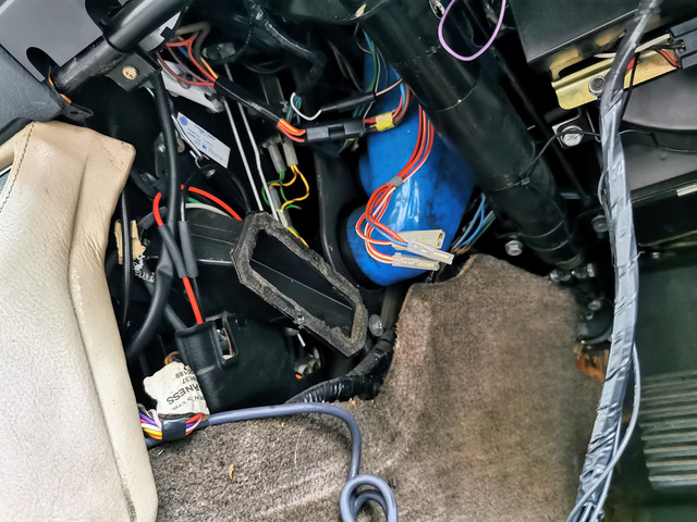

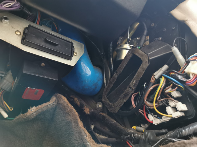

The other issues I had had with the heater were twofold. Firstly was a stubborn refusal to reliably blow hot air and secondly a continual cold draugt oh my left knee.
I think there are two issues here. Firstly is that something is amiss with the control logic and/or the Heath Robinson collection of motorised cams and vacuum actuators which control the heater assembly.
The level of complexity and lack of access look like fun!
I was hoping to figure out what's where when it's blowing hot then be able to temporarily lock it in that position...however you just can't see or get at it well enough. I'll need to fault find the control system I think.

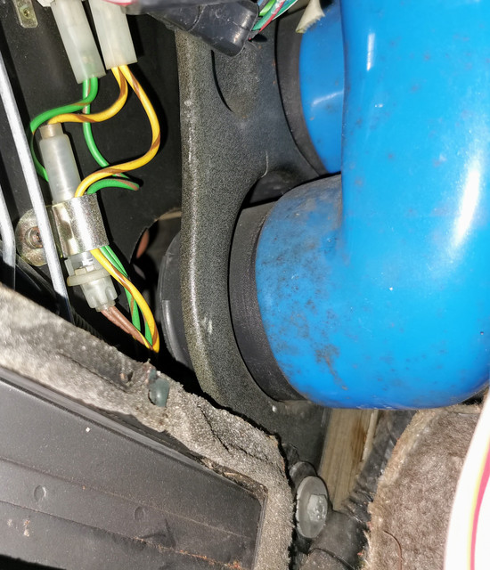

I quickly discovered that the blue thing which is the plenum sitting between the heater blower and the box containing the heater matrix were not actually attached to each other. You can see there's a good 1/2" of a gap at the end of the ducts.
The copper you can see there is actually inside the heater box itself.
The moment I touched this it just fell out. Wasn't attached at the top either.
This turned out to be Rather Annoying.
Turns out getting his thing back into position is *incredibly* awkward.
It needs to bridge the gap between the stubs arrowed in this image.
After somewhere between three and four hours of arguing with it while literally laying upside down in the footwell I gave up for the day. I just cannot for love nor money get the plenum to fit over the rectangular stub on the blower.
All the guides to servicing or replacing the blower motors seem to suggest attaching it to the blower before refitting it. So I'll probably need to get the whole blower out. Yay.
I guess on the plus side it was going to have to happen eventually to sort the speed controller anyway...but I was hoping to make this a quick job!

I have recommissioned a few of those Jaguar air conditioning systems over the years. They can be quite challenging and counter-intuitive.
Advice number 1: Don't waste any more time on the blue hose before diagnosing the system to work out what needs to be dismantled to fix it.
Some preliminary checks: The system is partly controlled by vacuum bellows and valves. A quick sanity test of the vacuum system is to see if the recirculation flaps in the footwells are operating correctly. After the car has been sitting for a while with the engine stopped, the recirculation flaps in the footwells should be closed. Starting the engine with the A/C switched OFF should cause the recirculation flaps in both footwells to open. Switching the A/C to LO at maximum temperature should cause the recirculation flaps to close.
With the ignition on and A/C set to LO, you should hear the servo motor move as you move the temperature control, don,t worry if the servo does not seem to respond at the ends of the temperature setting range, but do worry a little if (with the temperature set to one extreme or the other) the servo continually hunts and never finds a stable position.
Be aware that there is a vacuum operated shutoff valve in the heater hose, and these often corrode internally, becoming too stiff for the vacuum bellows to operate them reliably, there is also a 40° thermal switch in the water feed into the matrix, which shuts off the fans until the engine is warm, if the system is trying to provide heat. It is easy to get confused if the water valve is jammed closed, preventing hot water from getting to the thermal switch, causing the fans to be inoperative even when the engine is warm.
The speed control relay is below the A/C box, reasonably accessible on the passenger side, The speed control resistors are in the main heater box at the top on the passenger side, but these are normally very reliable.

xantia_v6 wrote: 08 Nov 2020, 02:09 I have recommissioned a few of those Jaguar air conditioning systems over the years. They can be quite challenging and counter-intuitive.
Few things needing separate responses here...
[] Shut off vacuum solenoid in engine bay. Thank you for explaining what that does. I knew (by experimentation) it cut off flown to the heater matrix when pulled in, but not the conditions under which it should operate. I will reinstate its vacuum feed and see if it drops out once the engine has been running long enough to get some heat in. It was disabled while I was trying to ascertain why it would only give me heat when it felt like it. This moves freely and smoothly I'm glad to report.
[] Fans. Being a HE this doesn't have the resistive ballast for the fans, instead using a transistorised speed controller more similar to the ones in a Xantia, if my reading is correct. Apparently there's a Darlington transistor which routinely fails. My fans both work, but only when the control is set to high or demist (or auto when it deems the fans should be running at full speed). Quite prepared to be proven wrong there by those who know these cars better, I'm still very much learning.
It's worth noting that the fans will work here from the moment the ignition is turned on...so if there's meant to be an inhibitor locking them out in heating more below a 40C coolant temperature, that doesn't seem to be working.
[] Temperature servo. This definitely does operate. My suspicions are that one or several of the following are going on...
A: the cabin temperature sensor value has drifted so it thinks it's far warmer than it is.
B: The sampling hose has come adrift so it's actually measuring the temperature right next to the heater box.
C: One of the directional flap actuators is sticky or weak.
D: The control logic has lost its marbles.
Getting decent heat out of it has always been an issue, though I now know why a lot of cold air was being ejected from under the dash (probably not actually from the floor level vents as I thought) as the driver's side blower wasn't attached to the heater box.
With it set to demist mode (which as I understand it should bypass the temperature regulation system and just set it to full hot with fans on full and air distribution set to 90% windscreen, 10% cabin) it will usually supply warm air for a few minutes, after which you hear a flap flip over and suddenly the airflow switches to stone cold. Sometimes cycling the control to off and back will get another few mins of heat, but not always. I'm not sure if this is a control issue, or if one of the flaps is just getting pushed over centre by the airflow and sticking in the wrong position.
You do always hear the little control servo motor(s?) wake up when you turn the ignition on, and the recirc flaps appear to work as designed based on your description. Though admittedly recirc is something I'd really rather have manual control over... especially until the air conditioning is back up and running fully. Suffice to say trying to demist a damp car without AC with it in recirc mode is an exercise in futility.
