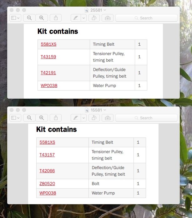

The attached pic. is lifted from the Gates catalogue, showing the 2 options of cam kits-
KP15581xs [ up to engine 1806404]
and KP25581xs. [from engine 1806405]
My 2003 is showing an engine no. FX3V2010458
It would appear [as you say] that the belt and pump are the same, but it seems that the tensioner pulleys have a difference.
I have ordered 25581- and we shall see!
