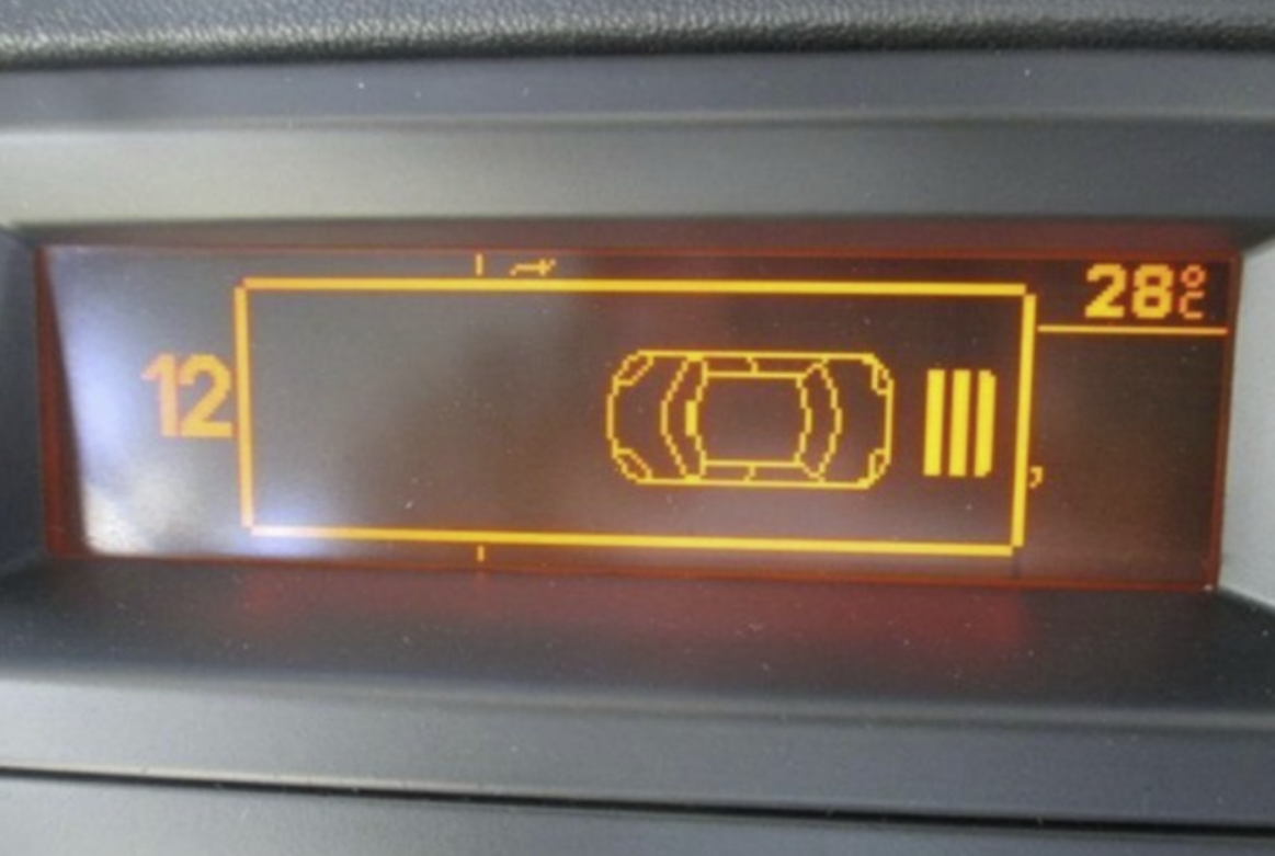

With RD4 the parking sensor display is on the multifunction screen, not the dash screen:
The only Instrument Panel display relating to parking is the Parking Space Gap Measurement:

No Marko, the RD4 units have the parking display on the multifunction screen above the Head Unit (and I'm referring to the Monochrome Orange EMF 'C' display). It was never an option on European based models to have it on the instrument display.
