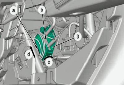

It's on the passenger side footwell, on the right side of the footwell centre console as you are sitting in the passenger seat:
You don't have a tyre deflation ECU to remove first on this model for the year, as it is indirect and uses the ESP ECU.
Disconnect the connector ( as "b").
Unlock the blower control module (3) ( as "a").
Slide the blower control module (3) (At "d").
Pivot the blower control module (3) (At "c").
Remove the blower control module (3).

Thank you very much. Now just to try to figure out how to get the trim panel off so I have access to the motor. Any tips? Cheers
