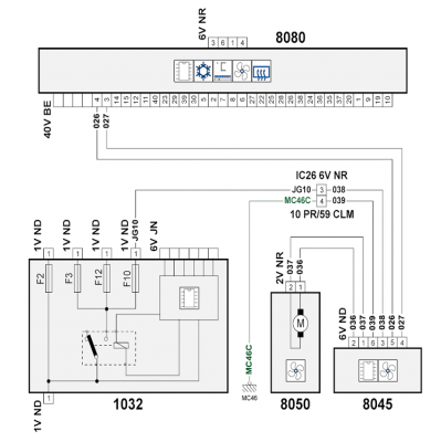

Unfortunately, a lot of the wire designations are not know - but on the diagram below:
8050 is the Blower Motor Module (where separate) and you can see that the earth MC46C connects via the interconnection harness to 039 at pin 4 which then goes to the blower module pin 6. So that is likely to be your earth - and the power looks to come from JG10 via fuse F10

Pin 4 027 when a continuity meter put between pin and chassis no continuity. Where is 8080 located.
- x 6957
Re: DS4 heater blower
Bear in mind that 8080 is the Air Conditioning ECU and these wires will not be live all the time - some of them are command wires.

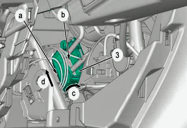

It's on the passenger side footwell, on the right side of the footwell centre console as you are sitting in the passenger seat:
You don't have a tyre deflation ECU to remove first on this model for the year, as it is indirect and uses the ESP ECU.
Disconnect the connector ( as "b").
Unlock the blower control module (3) ( as "a").
Slide the blower control module (3) (At "d").
Pivot the blower control module (3) (At "c").
Remove the blower control module (3).
