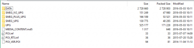

I have dloaded the latest maps they went on great but the speed cameras wont go on iv got aug 20 from the thread you sent me I don't think I got the right file as theres on 4 items in the folder ///mappe..upg...poi. .POI_VER.POI that's it

These are the contents of the speed camera file using the link in that post:
So make sure you have downloaded the file correctly (bear in mind that zippy is banned in the UK, so you'll need to use a VPN to access the link). Make sure you re-format the USB key again. Then extract the zip file to the key. You should have all the content listed above.
Obviously that speed camera file is out of date now - but at least you can see how to do the update and what types of files should be on the USB drive.
