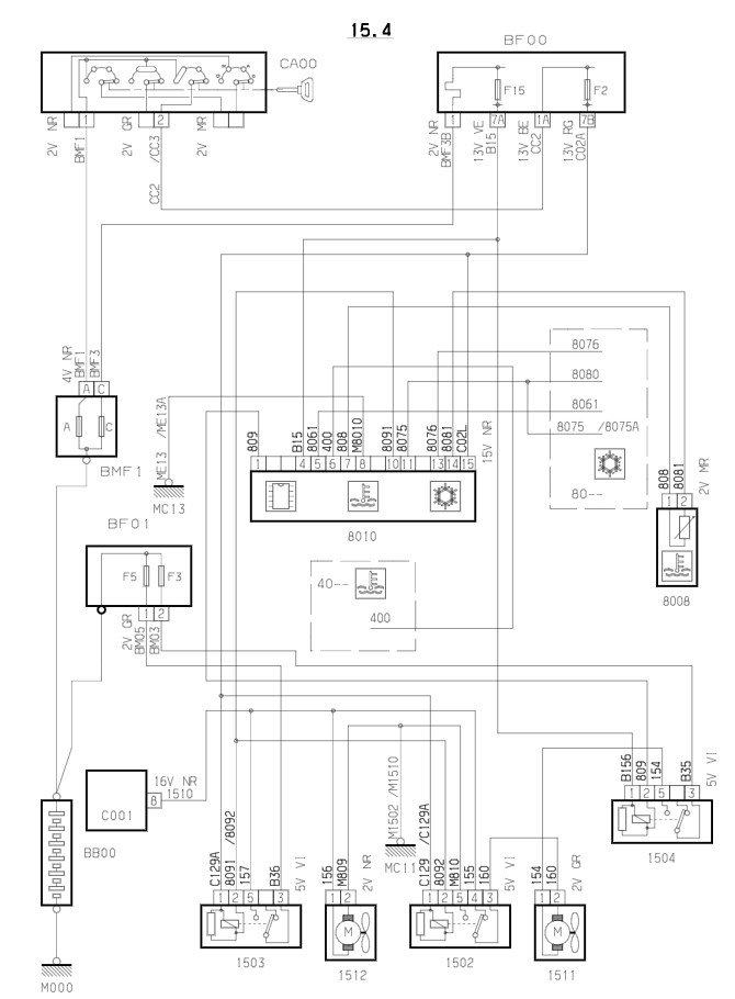

There are lots of cooling fan setup variations depending on model year & equipment, I would need the last 8 digits of the VIN to get the correct wiring diagram to have a look.

OK this is the diagram for the cooling fans, looks like you have the twin fan setup using 3 relays to alter the speeds.
The Left fan is 1511. I would start by checking the 3 relays in between the 2 fans, they are prone to corrosion due to the location.
Sorry i still dont understand why you are now removing fuses?

wheeler wrote: 01 Nov 2020, 22:21 OK this is the diagram for the cooling fans, looks like you have the twin fan setup using 3 relays to alter the speeds.
