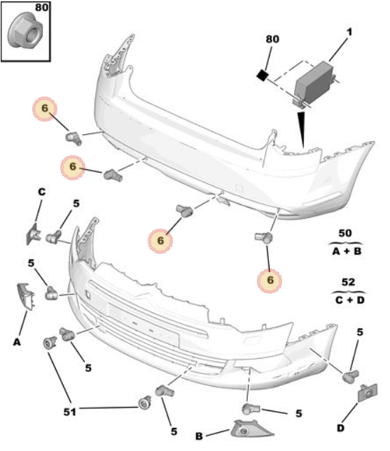

Right, so unlike the front that have sensor supports, the rear sensors are all in one as per item (6) below:
Part: 1611735680 - To be painted £133.30 each inc. VAT
So check to see if it isn't the actual bumper plastic that has cracked....
and if it's the rear bumper, then that is part 7410FH and a mere £663.00 inc. VAT.

There are no separate parts - the rear sensors are a complete sealed unit that plug into the wiring loom.
