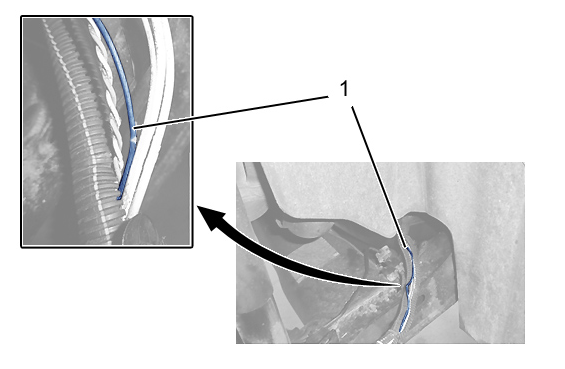

There is a technical service bulletin if you are getting an ESP or FSE warning lamp on with the "Brakes Fault" message, and one or more of the following fault codes:
C156C92, C00372F, C003712, C003711, C003701, C003762, C003A2F, C003A12, C003A11, C003A01, C003A62, C003811, C003B11.
If you are getting fault C156C92, then you need to check the continuity and insulation of the electrical harness between the ESP unit and the rear right and left brake caliper actuators.
You will need a special adaptor harness to do this and before doing so, the battery, ESP ECU, wheel sensors and rear motorised brake caliper actuators must be electrically disconnected.
So as this is a bit of a faff, you may want to get it booked in if you are having the warning message and this specific C156C92 fault code.
One of the specific problematic areas is on the rear intermediate electrical harness (1) in the area of the rear wheel arch on the side concerned, once you've released the wires from the spiral sleeve.
If they detect a problem with the wiring, then they will need to locate the issue which is likely to be a break in the wire somewhere.
If they have to replace the rear intermediate harness, it will be anywhere from 3.4 to 4.0 hours to do depending on your engine.

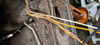

Okk so a little update, I found two corroded wires on the drivers side rear. I have soldered and heat shrieked the wires. Reset the fault codes using the code reader and re assembled.
Marc your an absolute hero for sending me in that direction! Thank you thank you thank you!

The fix requires investigation of the condition of the electrical harness and confirmation of the corrosion or wiring breaks as shown. If they are as described in my post then you'll need to affect a repair or replace the harness. But you need to investigate the issue first.
