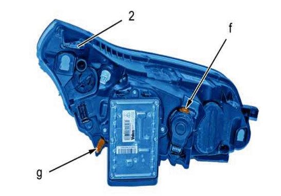

As seen in the video, when they get to the inner position, noise starts and projectors visibly judder as if they're hitting an obstacle or a limiter. Further examination and research got me a picture of the azimuth motors. They are connected to the projectors via a steel cable which seems to have an oval ring on it.
So, should I be nervous about the juddering and should I unscrew the torx holding the cable and move the projector outwards a bit so it doesn't "hit the limiter" any more?

Here's a video of my headlamps and here's a photo of the azimuth motor and the cable.

They may need adjusting or it may be that the motor(s)s are on the way out as it seems to be trying to turn the lamp past the 'stop' position and then keeps rebounding back and forth. There shouldn't be any grinding like that.
It may be the Azimuth adjustment motor(s) that are out of calibration. It shouldn't be anything to do with the height sensors as that is for the vertical adjustment. The only other thing is the headlamp ECU that performs the calculation.
But before all that - when did you last have the beam alignment checked? These can be adjusted (including the Azimuth position), but needs beam setting equipment:
Correct the vertical setting of the headlamp (height) by acting on the screw (at "f").
Correct the horizontal setting of the headlamp (azimuth) by acting on the screw (at "g").
Align the beam of light "j" of the headlamp slightly below the line de demarcation "h".
Note: Adjusting the dipped headlamp automatically adjusts the main beam headlamp.

Beam is checked annually on the MOT and is fine. I've tried turning the "g" knob for adjustment but it won't budge on either headlamp. But even if it was misaligned, would it be designed in a way that a slightly misaligned projector would judder on the "bump stop"?
