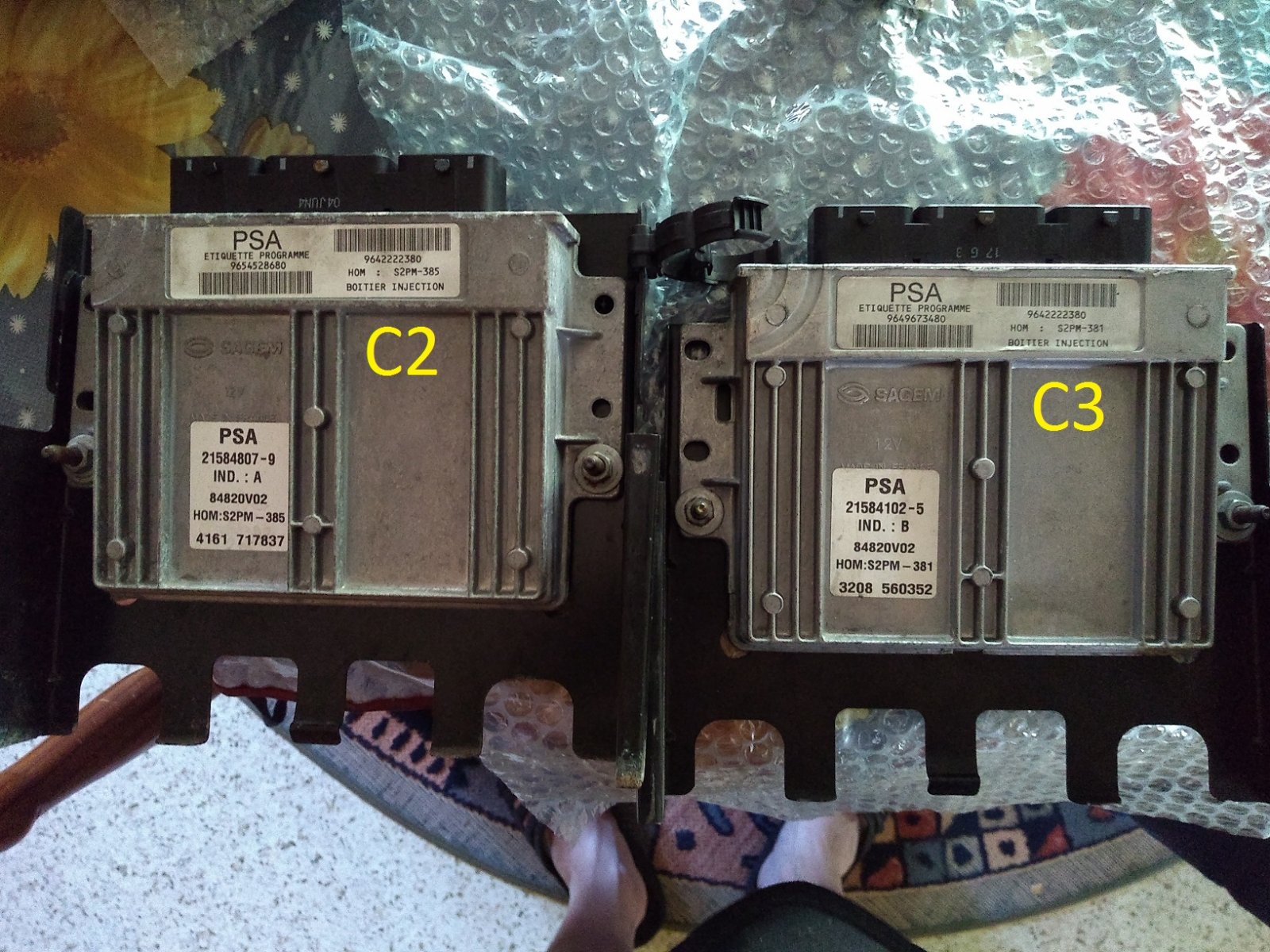

Unfortunately I dont have the number for the donor C2.
The number for the C3 is 9794.
The C2 AD said it was an from an 04 furio. I don't know if it helps but here is a pic of the two ECUs.
I have contacted the Ebay seller but I am waiting for a reply.
