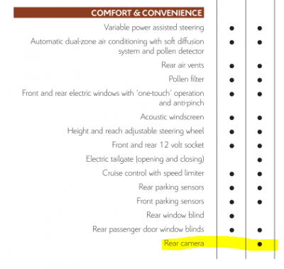

I have an Australian 2016 C5 brochure (probably the last before production ended) and it states only on the Tourer, so not sure what happened there....

Yes looking up specs it seems the sedans didn't have it. I was sure I had read it somewhere in a review, but can't find it now. It's possible the importer/distributer or even dealers were fitting some kind of camera just to get rid of the last C5's they had as by that stage in that level of car it was one of the have to have gadgets.

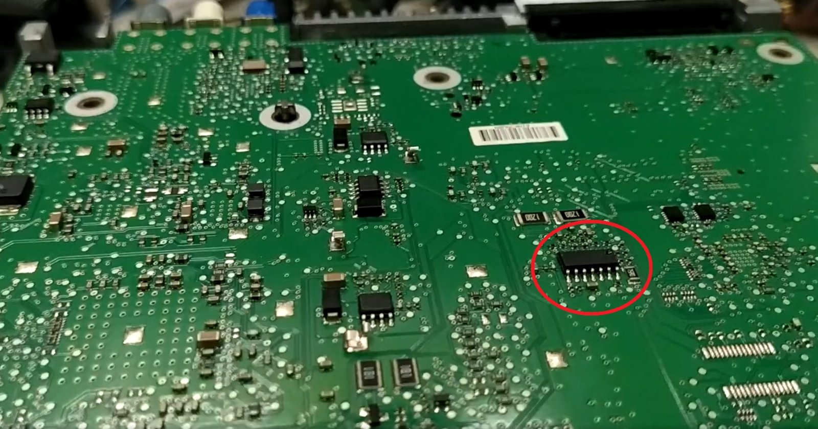

Just for confirmation regarding compatibility of the Reversing Camera on the RT6.
The long 10 alphanumeric code on the back of the Head unit (starting with 98xxxxxxxx) needs to end with 777XT to be compatible with a reversing camera. Other RT6 units won't have the hardware on the motherboard to work.

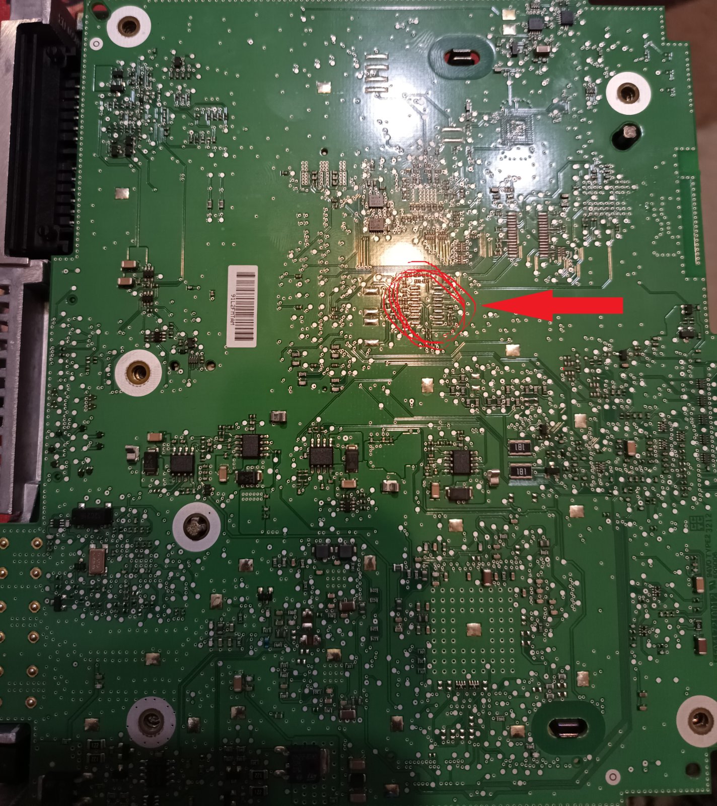

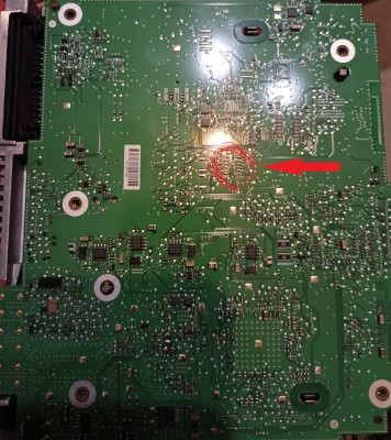

Hey guys - let's refresh this old discussion...
Last night I was looking at X7, produced Dec 2012, fitted with reverse camera from the factory. Attached below is the screen from Diagbox: Software version BSI: 11.80
I checked my C5, produced again Dec 2012, with RT6. The version of the BSI and everything else is the same (checked with DiagBox) .
I was reading in Russian forums, that the only problem for fitting a camera to RT6 is the BSI software version. Or google translate it that way Is it true?
So what do you think? Can I fit a camera?
OnlineGiveMeABreak
- Posts: 37330
- Location: West Wales
C5 MK I 2.0 HDi SX Wicked Red
C15 Romahome White
XM 2.0 SX Polar White
CX 20 Polar White
GS 1220 Geranium Red
GS 1000 Cedreat Yellow - x 5721
Re: Original reversing camera for RT6 - Citroen C5 X7 2015
Not to my knowledge. There are different versions of RT6. The versions that were made for vehicles with reversing cameras (like the later facelifted C5 X7 Tourer) have 2 additional micro chips inside the RT6 units to handle the reversing video functions. So in addition, to a correct RT6, you would need the correct wiring harness, the correct parking assistance module that also supports rear reversing camera, BSI configuration as a minimum and the correct wiring to the back of the RT6.
People have gone on about modifying wiring and taking feeds from here and there and modifying firmware - but from what I have seen, a waste of time if you don't have the hardware.
- XUD9
- Posts: 13
- Joined: 10 Mar 2020, 20:30
- Location: Sofia, Bulgaria
- My Cars: Citroen BX 4WD 1.9D 1989
Citroen Xantia 1.9TD XA2 1995
Citroen Traction Avant 11BL 1948
Citroen 2CV6 Club 1986
Citroen C5 X7 2.0HDI 140 2012 - x 5
Ahaaa...
If there are different versions of RT6 (with additional chips inside) - than unfortunately the answer is clear
I'm not afraid of wires, but if the hardware is not 'rev camera ready' - there's nothing I can do...
Just tried to activate the options and see is it going to display a black screen with parking lines, but unfortunately nothing happens.
- In BSI, under configuration >> driving assistance >> Parking assistance >> Front + Rear proximity sensors + distance measurement + camera (last option) ;
- In telematics, configuration >> vehicle configuration >> Video input from reverse camera >> Present;
WARNING!!! Be careful if you are changing configurations!!! If something goes wrong during the process of uploading changes (lost communication, computer restart/shutdown) - this can brick your module, and even the whole car!!!
In my case - it took about 2 minutes to update "video input" setting. Restarting, loading, ect....

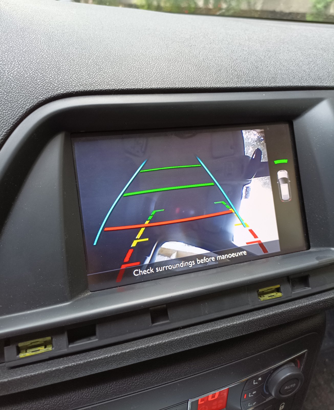

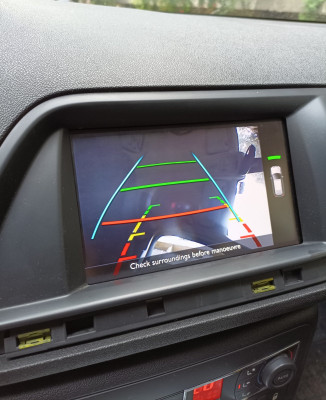

Yes, in the end I solved it exactly this way.GiveMeABreak wrote: ↑21 Sep 2016, 12:53 Maybe there's another option - something like this:
http://media-in-motion.co.uk/reverse-ca ... onnection/
Libor
