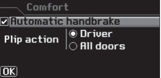

Our new 2.2 Exclusive opens all doors on the first press. When I go to the Comfort menu, the option to select 1 or 2 stage opening is shown and selectable. BUT! Nothing changes and when I go back to the menu, it's gone back to "all doors" (or whatever the wording is).

Ok, so if you have the option as shown below, then that means it has been activated in Diagbox (if it was not activated, the menu option would not be shown in the LCD menu):
If you have Diagbox there may be one of the following fault codes shown that could affect the operation of the selective locking (Driver´s door):
A4ED Short circuit to the BAT+
B4ED Short circuit to earth
C4ED Open circuit
It may still be double checking the option is still enabled in the BSI configuration though to be sure.
