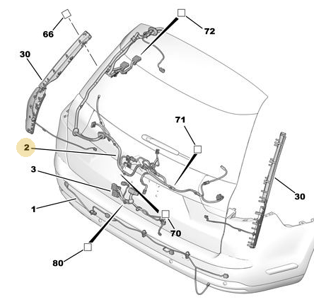

Next - I understand perfectly what the RT6 is
Next the harness - you will NOT have the correct electrical harness for the year, regardless if the tailgate has a patch or not. These have different part numbers:
Item 2
Your build date is: 13092 (12 September 2012)
Your tailgate harness is part: 6434SX with markings 9686035180 / 9686035280
which is for vehicles with build date 13020 to 13747 (2 July 2012 to 29 June 2014) and without front / rear obstacle detection with camera system.
The harnesses for models with this system are:
9800224080 for models with motorised tailgate and front / rear obstacle detection and camera from build date: 13020 to 13747 (2 July 2012 to 29 June 2014)
9809676380 for models with motorised tailgate and front / rear obstacle detections and camera from build date: 13748 (30 June 2014 onwards)
So you can see they are different harnesses, so will not take a camera connection.
