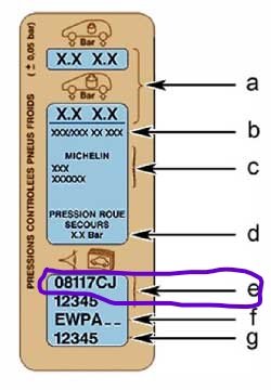

Whats your RP number? can be found on the sticker with your tyre pressures on it.
- Attachments
Re: dispatch front drivers window regulator wiring
RP 11301U9 that's the 1st line
