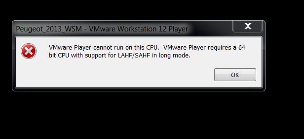

Well in the end..... I coud not get anywhere with the ED download. But to be fair, and because there was no mention that I would have to uninstall Diagbox on my 32 bit laptop, and that was a no no, so I brought back to life an old 64 bit desktop with a quad 3.4 CPU. But this CPU clashed with every thing it met. 1 example attached.
So I went for an Ebay 1.99 special. It came bundled with VM Ware. This I loaded onto Win 7 64 bit running on boot camp on my Mac.
